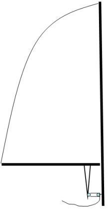

Originally posted by craiggo
GRF,
The temple vang is basically a prodder extending out of the back of the
foredeck. The kicker is then attached in a vertical plane between the
prodder and the boom. In theory this only increases leech tension without
all the lower mast bending. The picture shown by Jack shows the prodder
on the mast stump.
However there are drawbacks with the temple vang. Sometimes it is
desirable to induce bend in the lower mast. For this reason the Scorpions
experimented with having both a conventional kicker and a temple vang.
I have to say though I reckon there is more chance of snagging yourself
on the prodder than there is of getting caught by a standard kicker.
Alternatively GRF, you could fit your boat with a full width cockpit
traveller and then you'd only need the kicker for downwind work. Sheet
the main on hard upwind to control leech tension and play the traveller!
Just to correct you, that's the boom the temple vang is on in that picture
not the mast. Its on the mast end and points downwards. It is then pulled
in towards the front bulkhead with a pully system, they are great for
crews, and pretty powerful too, just need to make sure they are very very
strong!

Originally posted by MikeBz
A conventional kicker produces a forward thrust at the gooseneck which is proportional to the amount of kicker tension (thus proportional to the leech tension) which induces bend (there may be strut(s) or lower(s) to counteract it).  The kicker pulls back at the heel of the mast with a similarly proportional force, but because it's at the heel it has no effect.   So put simply, more kicker equals more bend trying to be induced at the gooseneck.
A gnav swaps these 2 forces over - the forward thrust is induced further up the mast where the hardware meets the mast.   This is countered by the boom being thrust backwards with a similarly proportional force.  In this case the backward force on the boom (which presumably is bolted to the gooseneck in some way otherwise it would just fall off) will to some extent mitigate the forward force at the top of the lever.  In practice this 'push-me-pull-me' act some way up from the heel of the mast will be trying to induce an S-bend - imagine you've got a long whippy cane, both ends clamped, and then you get hold of it with both hands and pull with one hand whilst you push with the other.
I would have thought from the above that the gnav would induce less bend, albeit subject to positioning of struts/lowers/gooseneck/heel etc.  That's an intuitive guess rather than an engineering/mathematical proof - although it wouldn't take too much of an engineer to come up with the proof (or otherwise).
Agreed, Mike, up to the point where you say "the gnav would induce less bend".
With a conventional kicker you can use a ram or lower shrouds to effectively lock the gooseneck in position, so that the only effect of the kicker is to apply leach tension. With a gnav, sure you can lock the position of the attachment point of the gnav on the mast in a similar manner, but to prevent bend you also need a system to stop the gooseneck moving aft, inducing bend. Some sort of puller or second ram at gooseneck level would do it, but I've yet to see it, and do you really want two arrangements to manage?
On the 3000, the gnav brings big benefits in terms of crew space - especially welcome in light airs - but it comes second to a conventional kicker in terms of mast bend control, imho.
I'd actually already considered using the composite kicker-gnav system proposed by GRF, which could be rigged such as to remove the aft pull at the gooseneck and the attendant bend (effectively you'd be pulling the gnav slider from the heel of the mast instead of from the gooseneck). Use the combo in a blow when mast bend control is critical and remove the kicker in light airs when space is more important. But so far, it's seemed like to much faff - deficiencies in my sailing are far more significant than any minor gains achieved, but for top sailors maybe something to consider.
