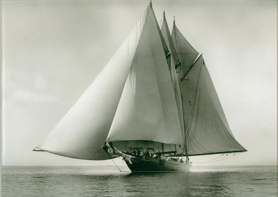

Here's pic, Description says "Atlantic dead before the wind spinnaker set August1916" is the spinny the thing sticking out on the left??? or the one on the front?? I dunno
Edited by GK.LaserII |
JimC ![]() Really should get out more ![]() ![]() Joined: 17 May 04 Location: United Kingdom Online Status: Offline Posts: 6661 |
The spinnaker is the one on the pole out to starboard. The pother is probably a balloon jib I guess. In those days the spinaker was set to windward of the jibs, not to leeward. The reason for that escapes me!
landlocked ![]() Far too distracted from work ![]() Joined: 06 Oct 06 Location: United Kingdom Online Status: Offline Posts: 222 |
the description says that the boat is dead before the win ie dead run so it's just like goosewinging the jib surely?
