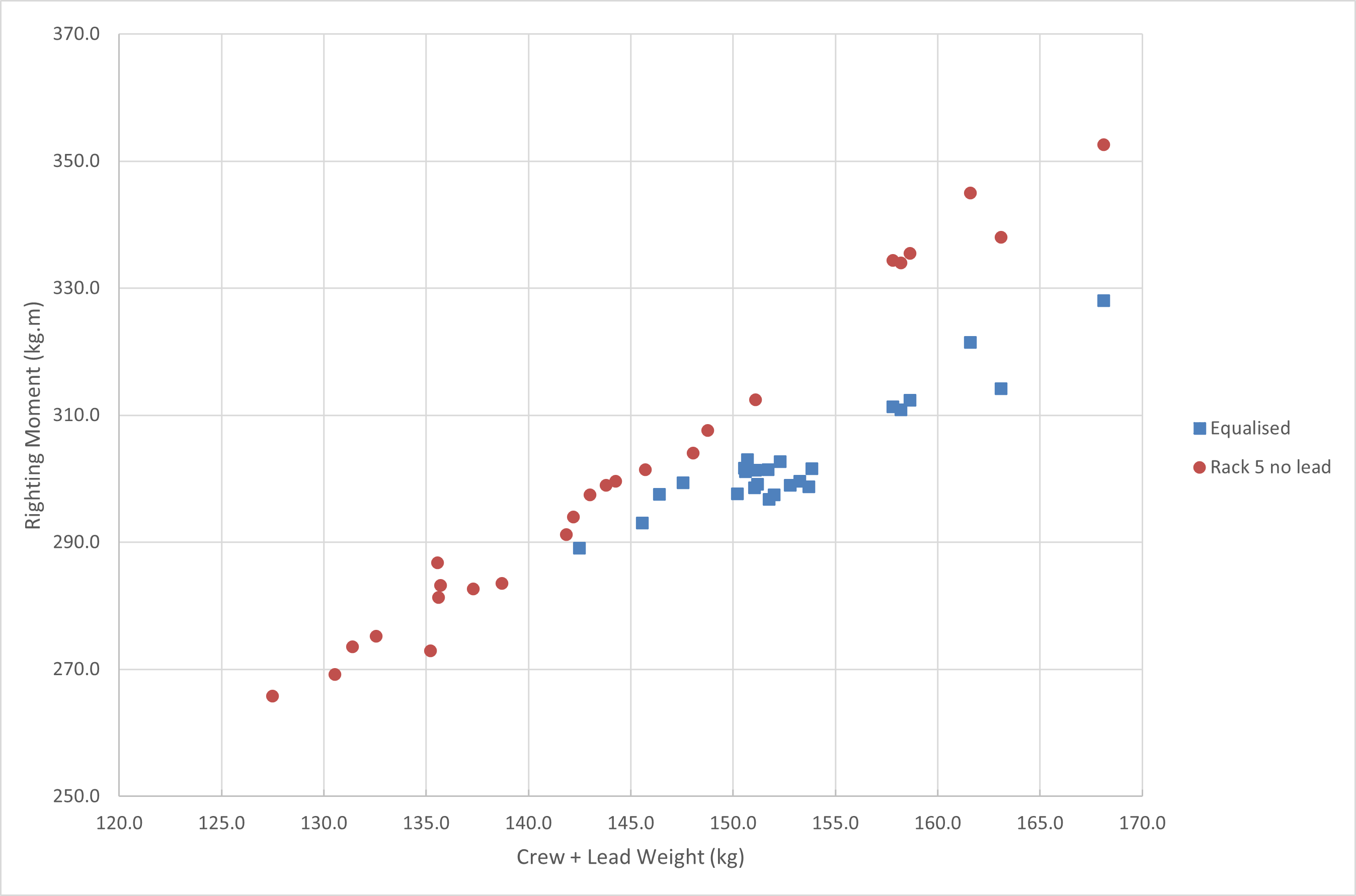

The 800 system works really well. It equalises for leverage and weight within a range. As someone who likes these things I've done all the calculations and mathematically it checks out, but also in practice it works very well.
The result is that the majority of the fleet are sailing in a very narrow bracket and even those outside the bracket are brought closer together. The major pro to this, is as a twin trapeze skiff that need a good size water to sail on, it's already a pretty narrow niche, so broadening out the competitive weight range help maintain good sized fleets. This is less of an issue for an olympic boat, but very welcome on the amateur scene. Downsides 1) is the boat is effectively 'slowed' down to equalise, if you consider maximum racks and no leads as the boats true potential (personally I find the boat plenty quick enough in equalised mode and making it any faster would likely lead to more breakages, a harder boat to sail, and smaller fleets) 2) it's admin weighing in at each event 3) lead is surprisingly expensive 4) inevitably where people aren't weighed in there are people on the wrong settings (although there is a pretty simple calculation you can do which will get you 90% there) For me 1 isn't a negative and the rest are worth it to open up the competitive weight range. ![]() |

1) Is the ideal weight for the boat above, within or below the equalised weight/ If it was found to be (and that might vary on forecast and venue) then everyone would end up off one end of the scale. 2) If you are have a BMI < 21 it is possible to be off the low end of the weight equalisation (i.e. you have the maximum 5 lead) but you are still on the leverage scale. This results in you sailing at the same leverage as the boats equalised, but lighter (always preferable) 3) If you are very tall and again have low BMI it is possible to be off the leverage equalisation but still on the weight equalisation. This means you are sailing at the same weight as the other, but with more leverage (okay if windy) 4) If you dip weight before weigh, then rehydrate, in you sail the boat heavier than everyone, but with more leverage (okay if windy and within the range of how much you can dehydrate) 5) if you bulk before weigh in (then pee / poo) you sail the boat lighter than everyone but with less leverage (okay if light and within the range of a poo / wee) Most of those 'gains' are within a pretty narrow range and some have a downside. My gut feeling is that the ideal weight is within the equalised range. So unless you are confident in a forecast you'd be taking a big risk to do 1, 4 or 5. Guy and I fell in to line 2 for the 2020 nationals (rack 9/10 and 5 leads). If we were professional I would make sure we hit that weight every year. But, it's only a 1.5 kilo advantage. We could have dropped about 1.5 kilo and gone to rack 10 and taken a 3 kilo advantage. But with a system weight of ~300 kilo this is very small gains.
And we've also won two nationals on rack 6 and 7 and three and four leads. And we've also won plenty on rack 5 and three leads at other events. Edited by Mozzy - 01 Jan 22 at 10:02pm |
