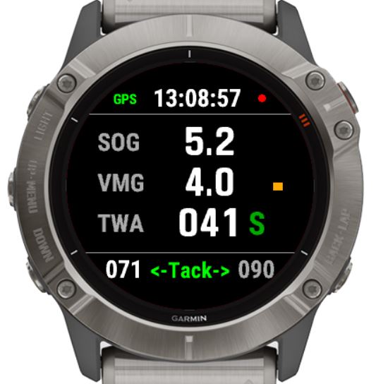

Hello Peter,
A fair number of GPS systems do require a waypoint or mark to navigate to before they provide a number for "VMG". What they are actually providing is velocity toward the mark, not upwind or downwind VMG and not velocity along the rhumb line.
With these systems, if you enter the location of a mark that's upwind of you and begin navigating to it, they show the component of your course and speed that's taking you toward the mark. The result is that they display a "VMG" value that decreases to 0 as you approach the layline. That's really misleading and it's been misunderstood by a lot of folks I sail with.
If you want upwind / downwind VMG you'll either need a system with wind sensor, or a smart app that determines true wind direction as you tack. Since I wanted that and a lot more and couldn't find it in a handheld device or a GPS watch, I developed an app that provides me what I want while I'm racing. It provides upwind / downwind VMG from a good estimate of true wind direction along with VMC (velocity along the rhumb line), tacking angles, angle to the mark, start timing, etc.
It runs on fairly inexpensive Garmin watches (~$200 and up).
You can check out the Sail2WIN app on my web site, or at the Garmin App Store.
Here's a screen shot:

I developed an app for Garmin watches that handles both of those issues. As for pinching up 5 degrees vs a 5 degree lift, GPS systems without wind instruments won't be able to tell the difference. That said, GPS based VMG can be quite useful if it detects your tacking angles and updates it's understanding of TWD as you go.
You can check out the Sail2WIN app on my web site or at the Garmin App Store.
