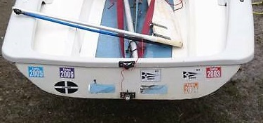

Post Options Post Options   Quote Sam.Spoons Quote  Post ReplyReply Direct Link To This Post Posted: 29 Jul 19 at 7:50pm
A bit less freeboard but it does look similar to this one :-
