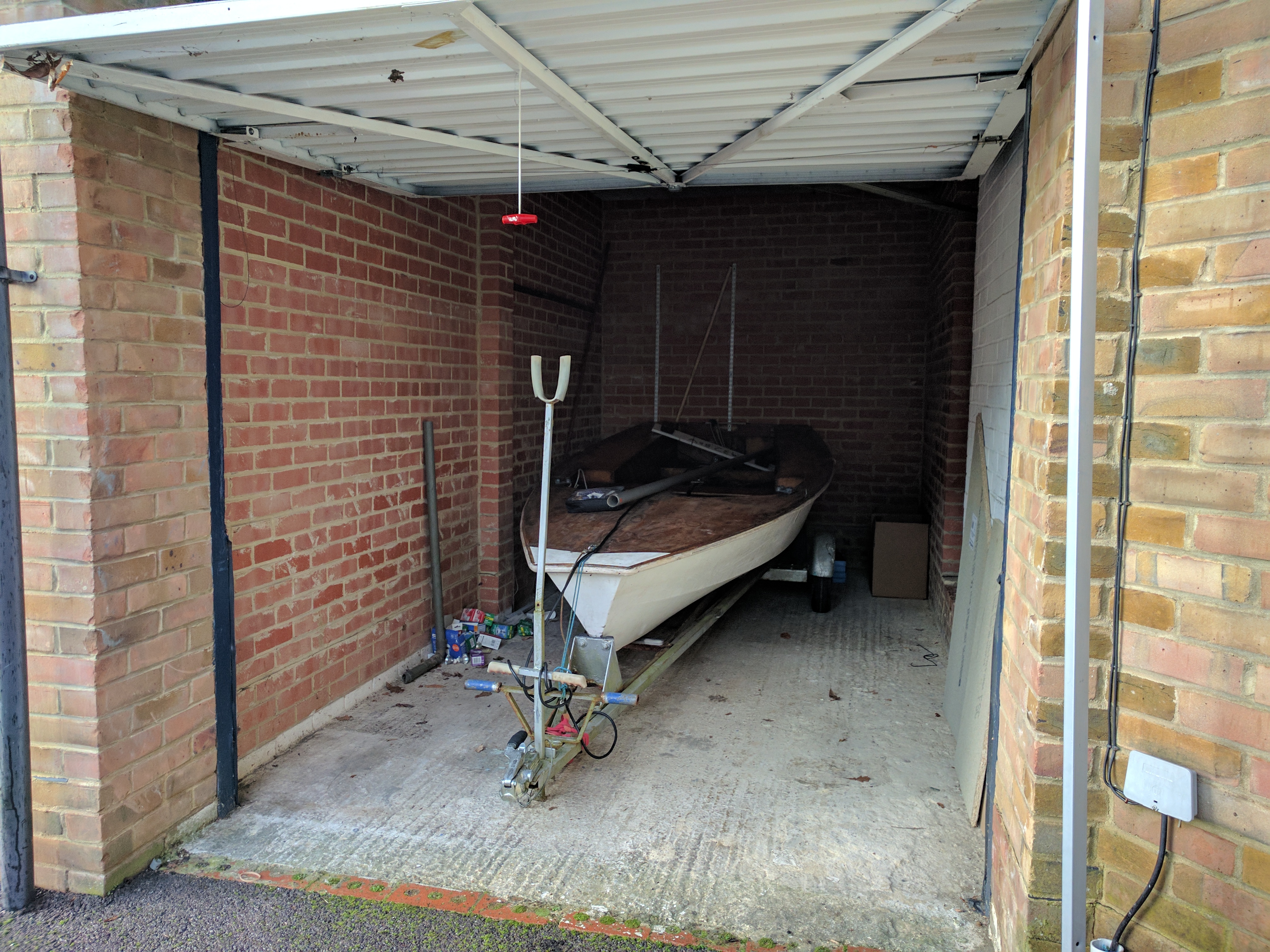

from the pics it looks like you do not have a highfield lever to hook the jib halyard on to (and generate rig tension) so if you want to keep it that way 4mm pre stretch would be fine, something with dyneema core will stretch a little less, if you fit a highfield, then the jib halyard will need to be wire and a decent chandler will make this up for you.
For sheets 8mm would be fine, or thicker depending on what you want to hold on to. For the tack - this doesnt attach to the boom, but a short piece of line connected with a couple of inglefield clips around the mast and through the cringle in the tack keeps things tidy. for the clew - a length of 3mm pre stretch from the sail, around a block on the end of the boom and then inboard to a jammer on the boom would be all you need, do you have a track on the end of the boom? if so you can shackle the sail to a slider in this track. Kicker, the pics show a pulley system in situ, the only issue with this is that you might want to lead controls for this back to the thwart on either side for ease of use, I would probably make up a dyneema cascade (have a look on the Harken website for some diagrams of this. You will find that the round boom you have is very flexible, and so use of kicker is compromised, you may find a new superspars boom would be stiffer and more effective. cunninghams are not often used on the miracle (I only bother rigging mine when its properly blowing) |

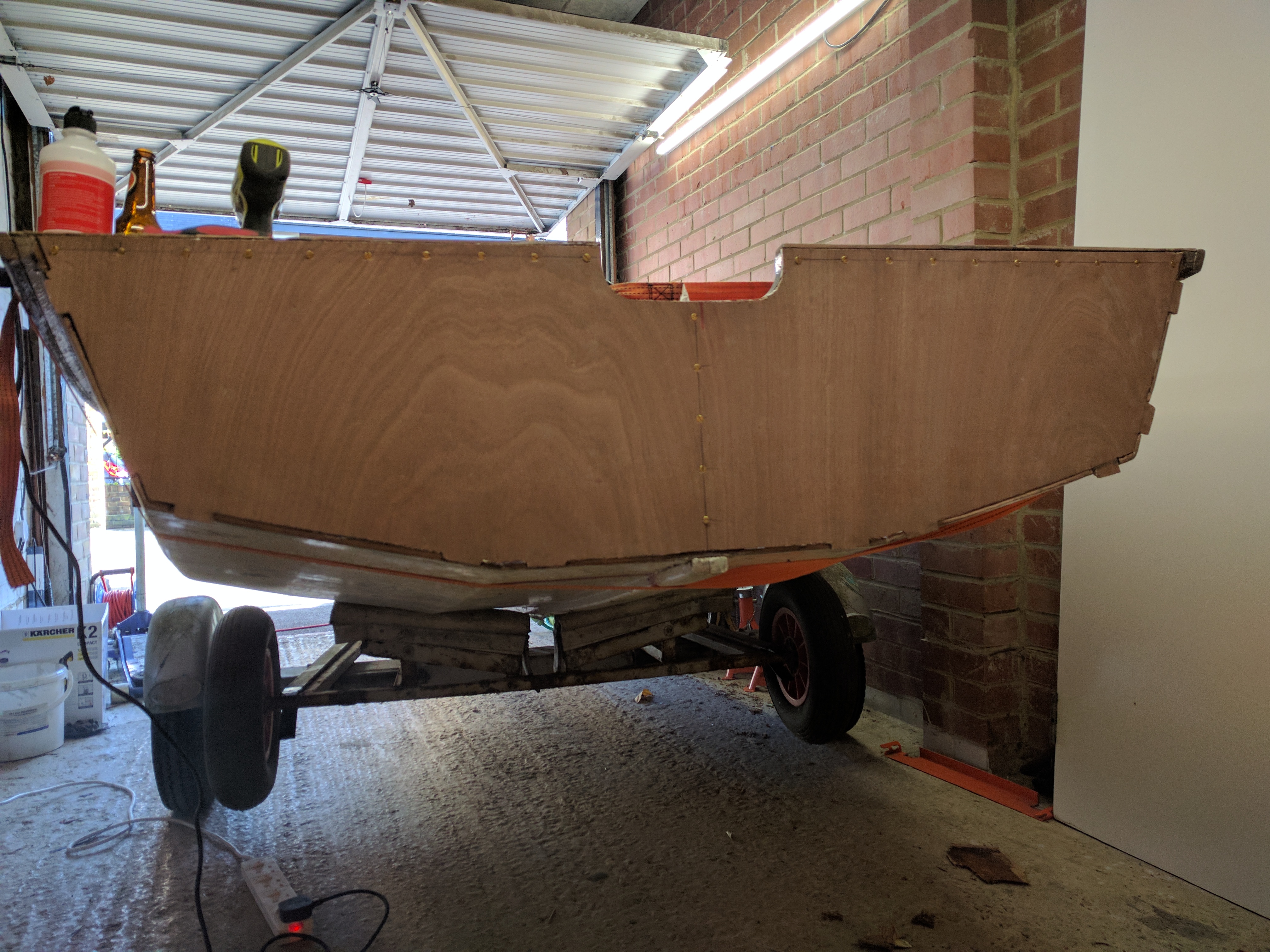

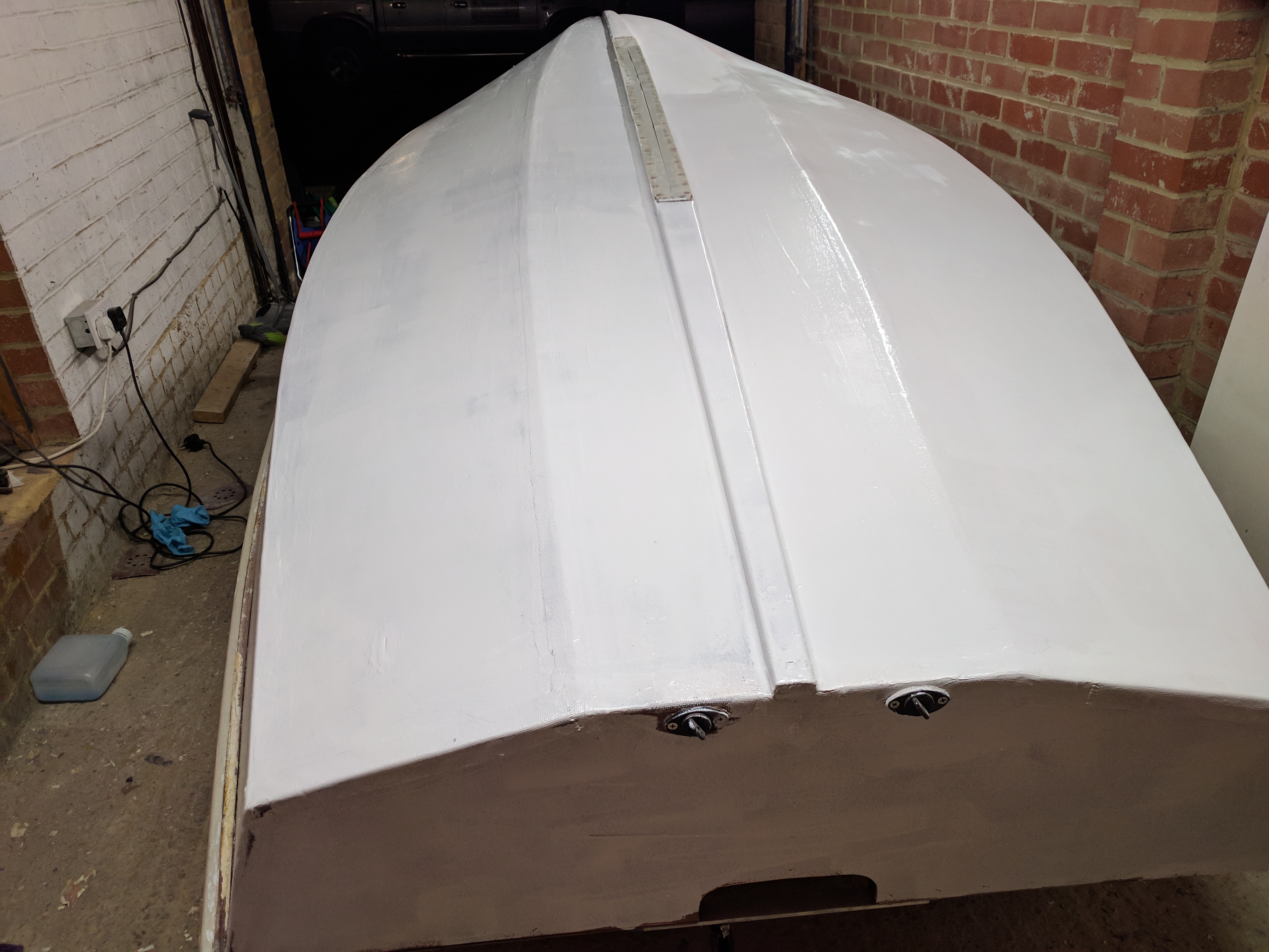

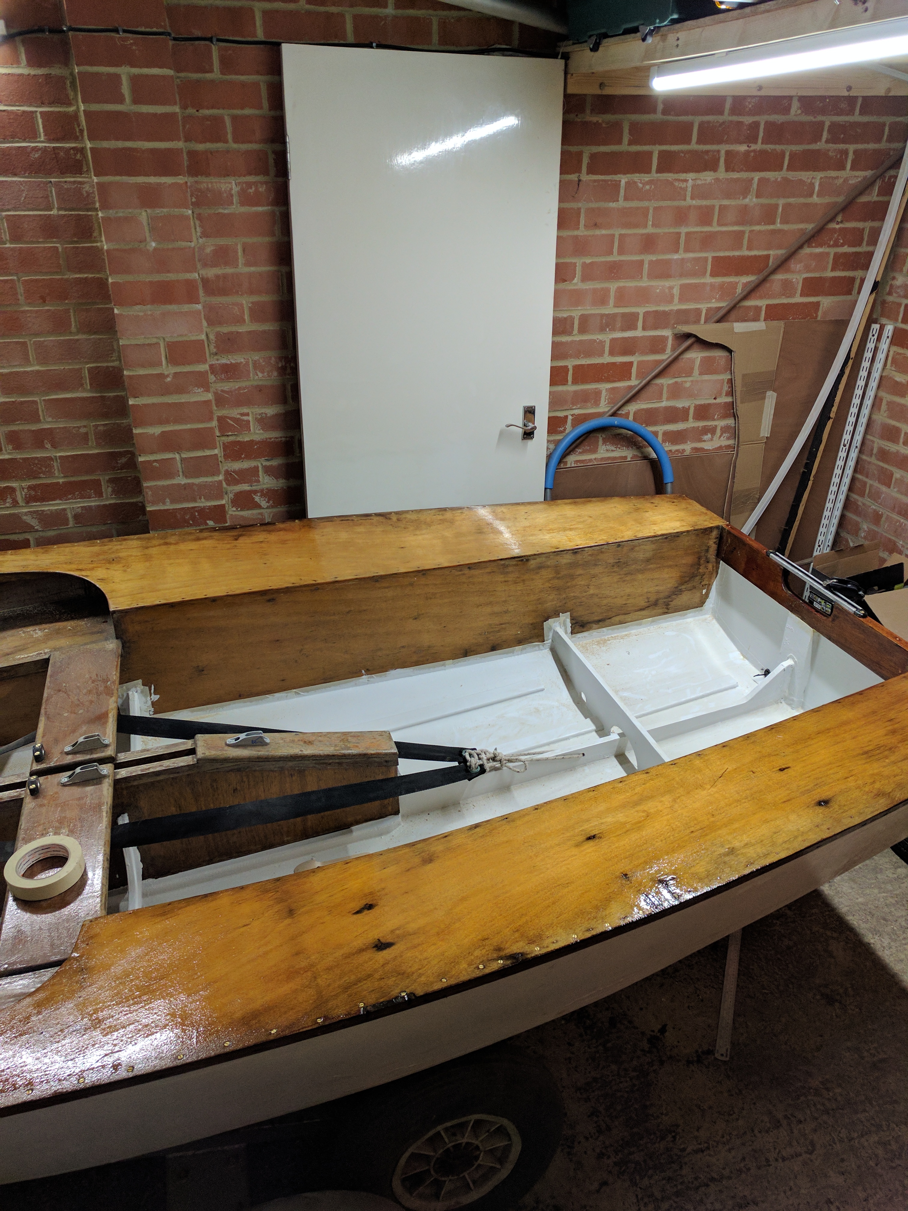

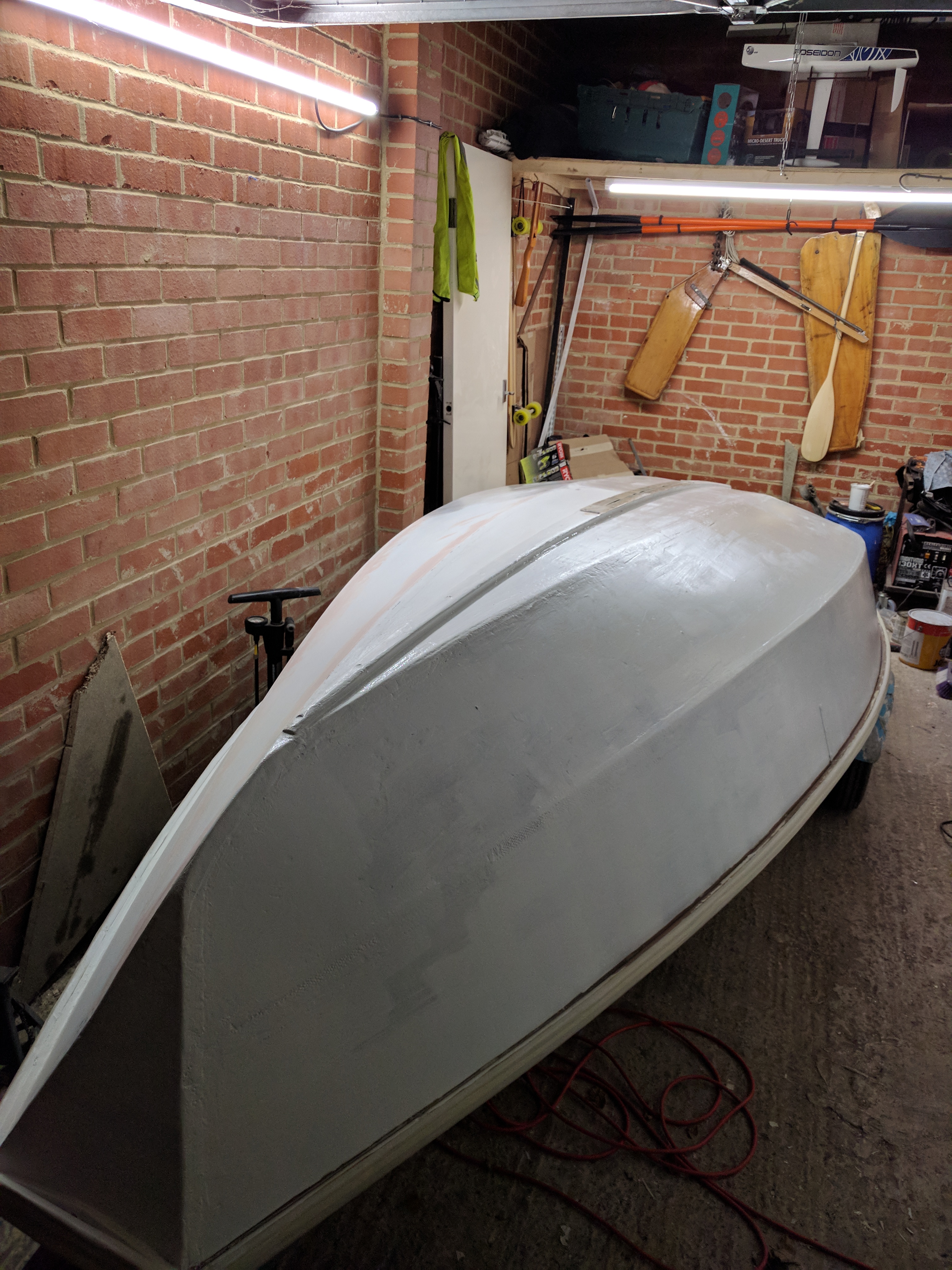

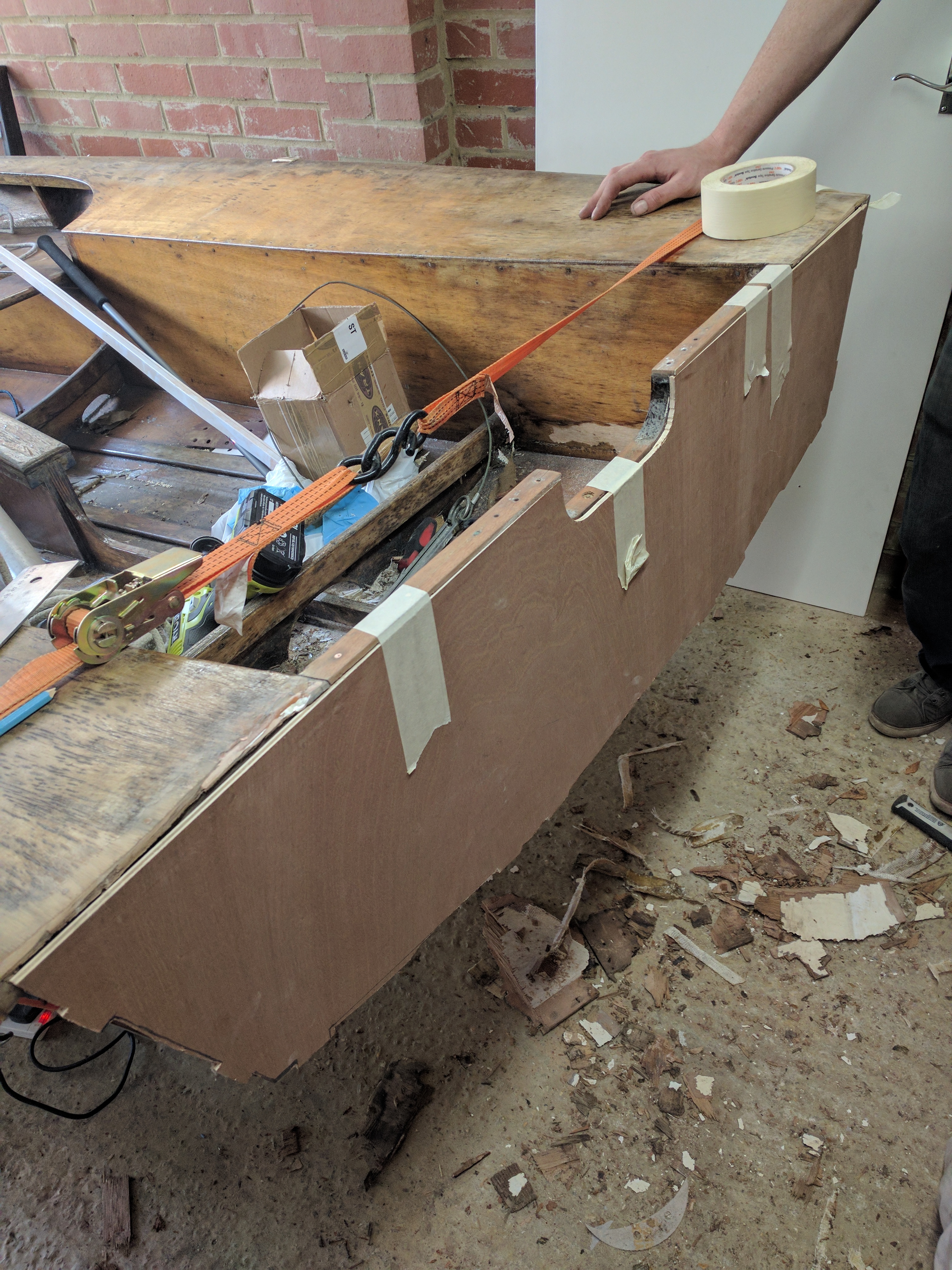

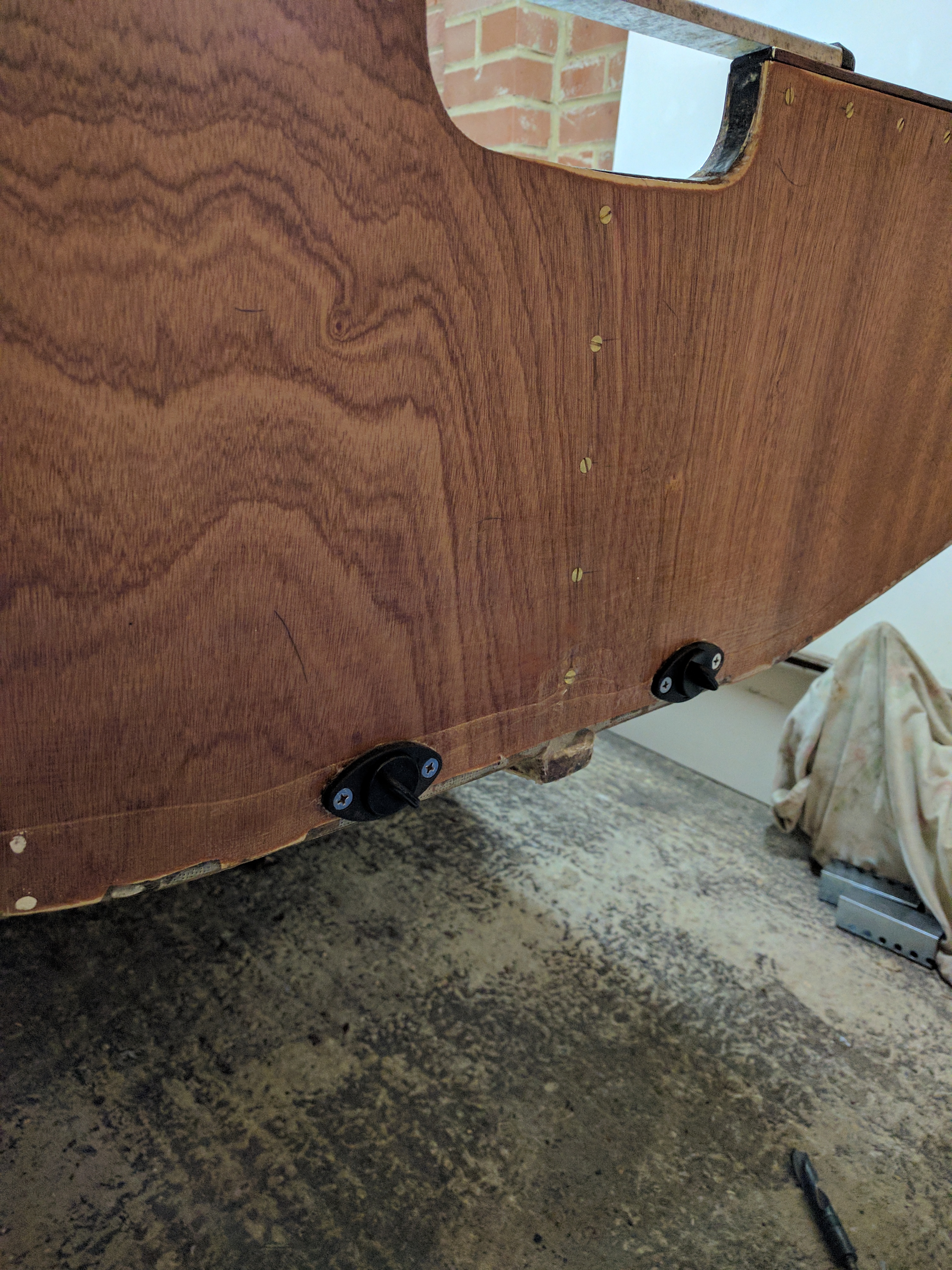

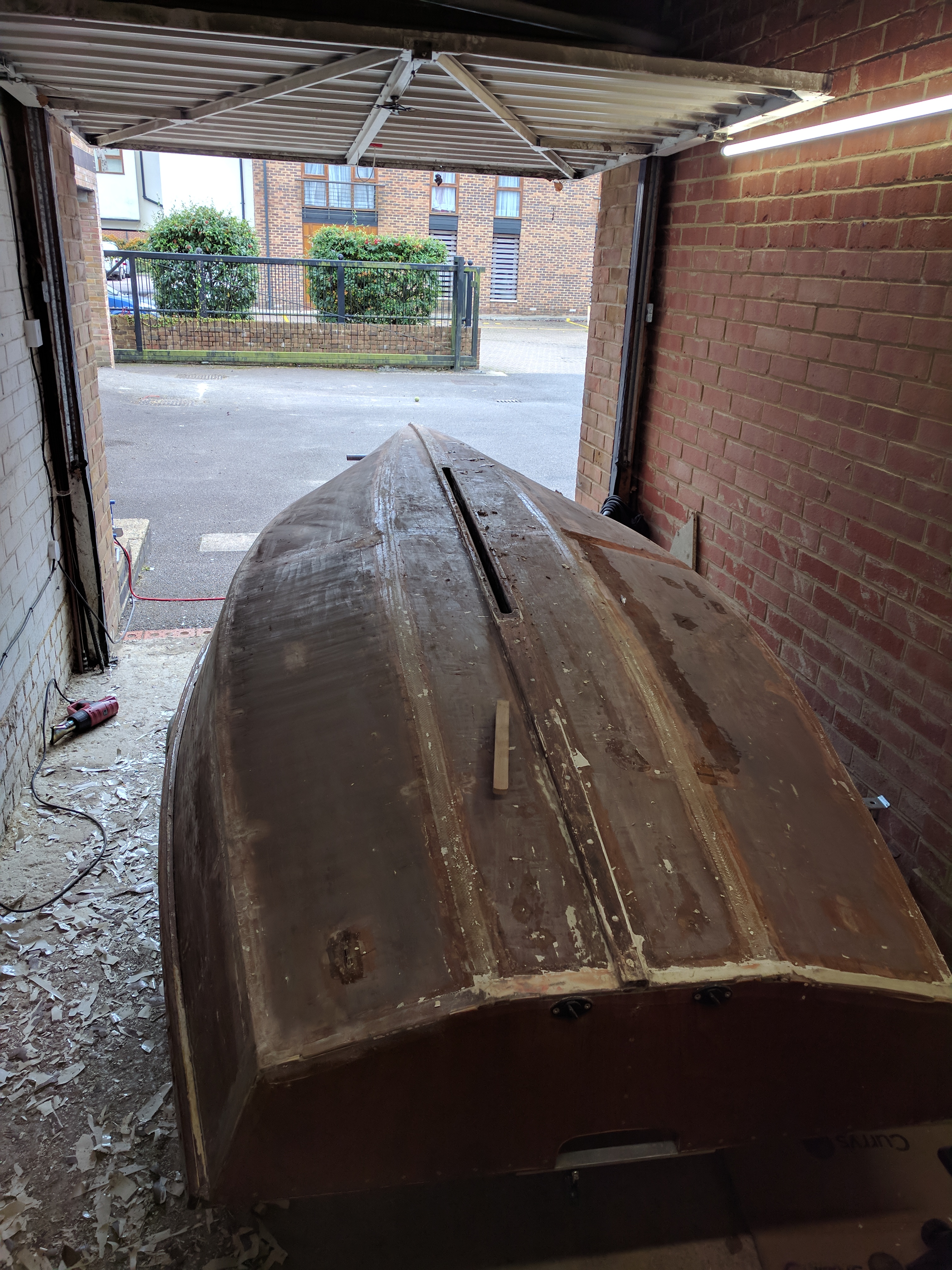

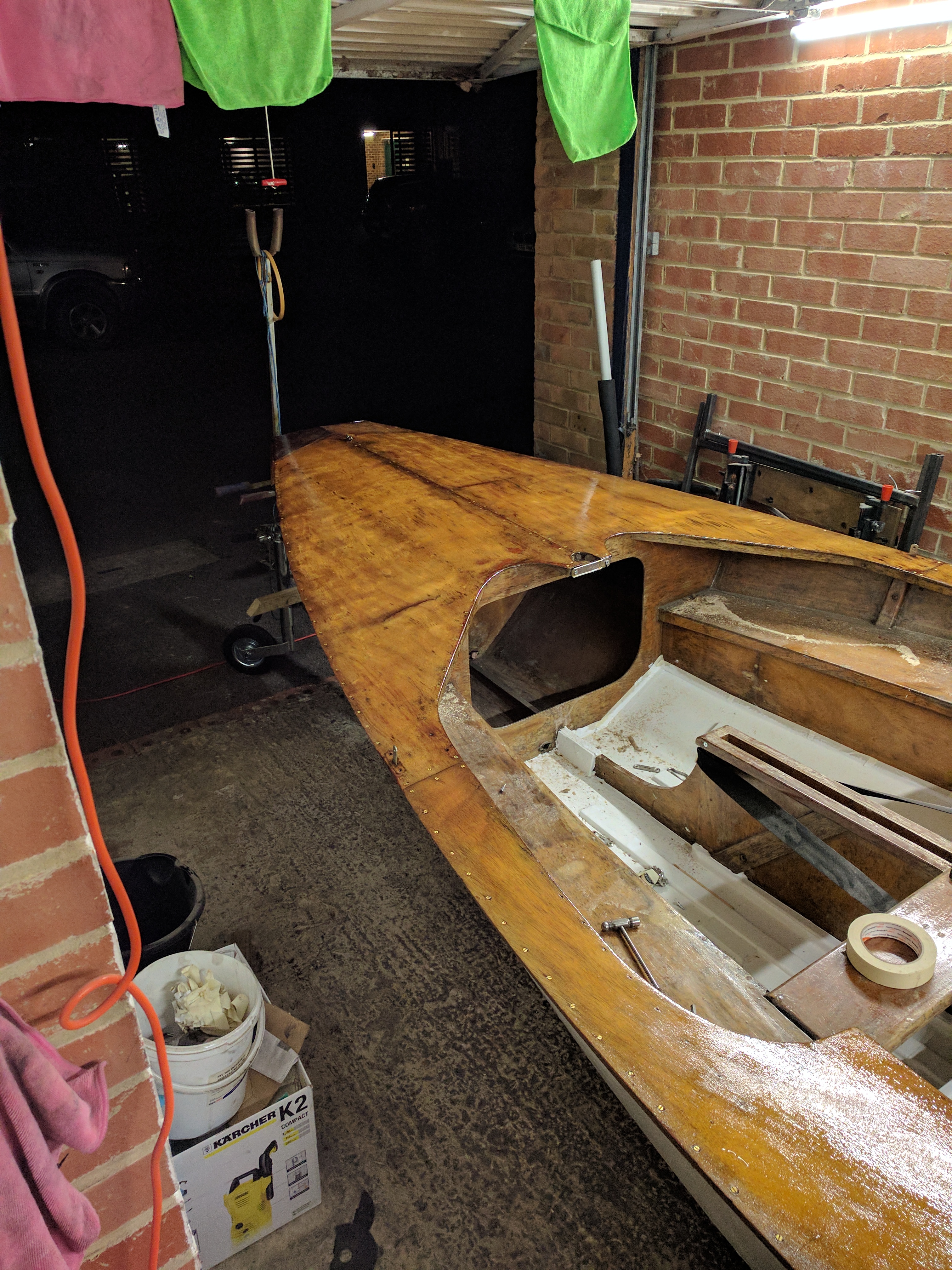

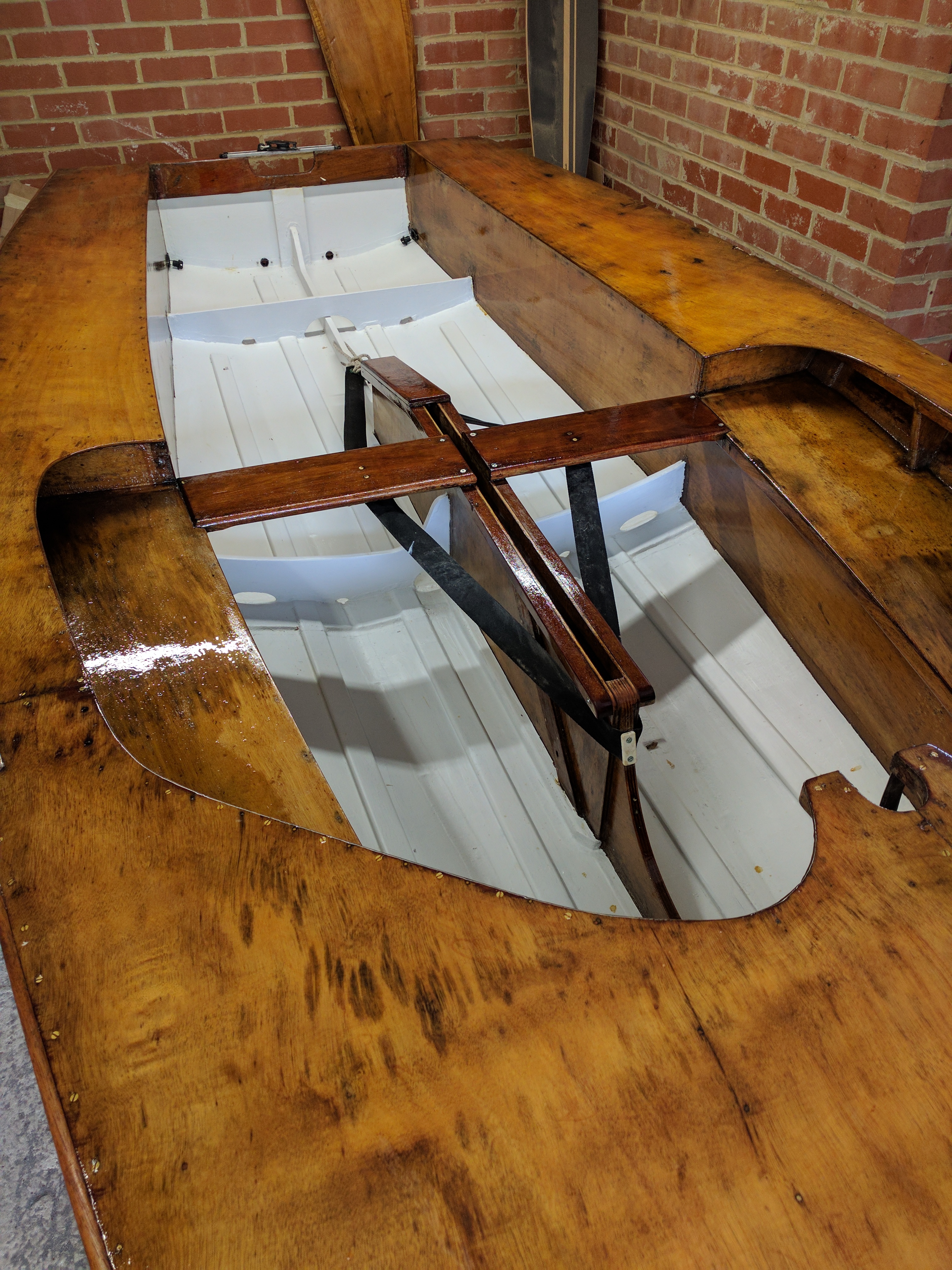

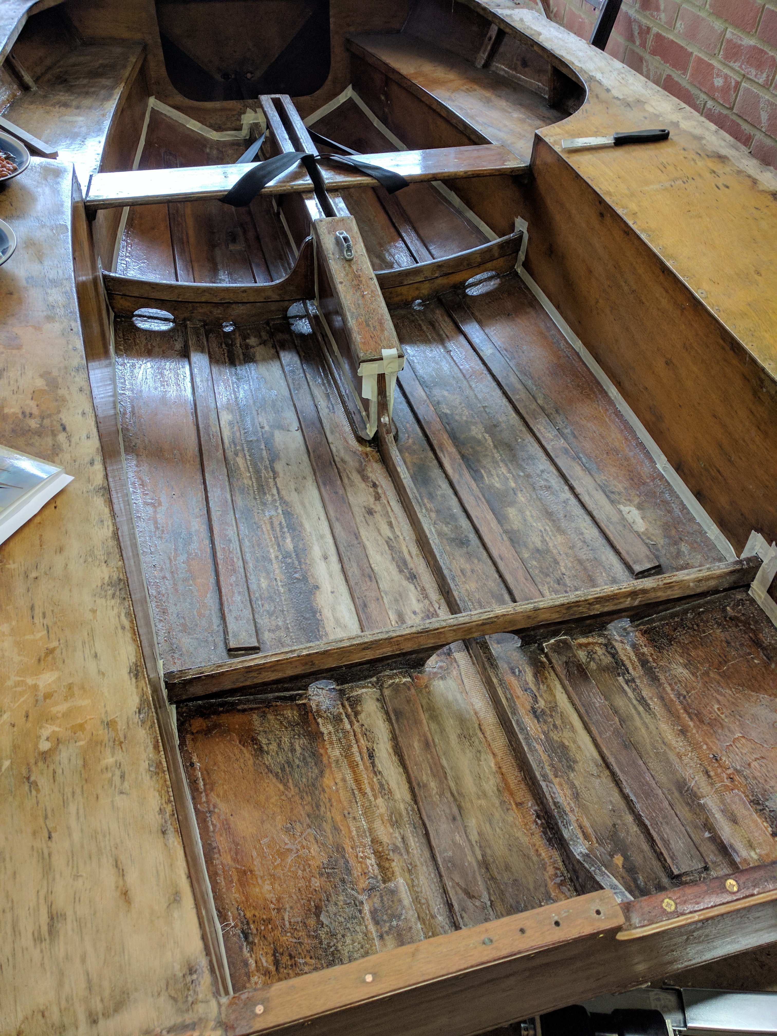

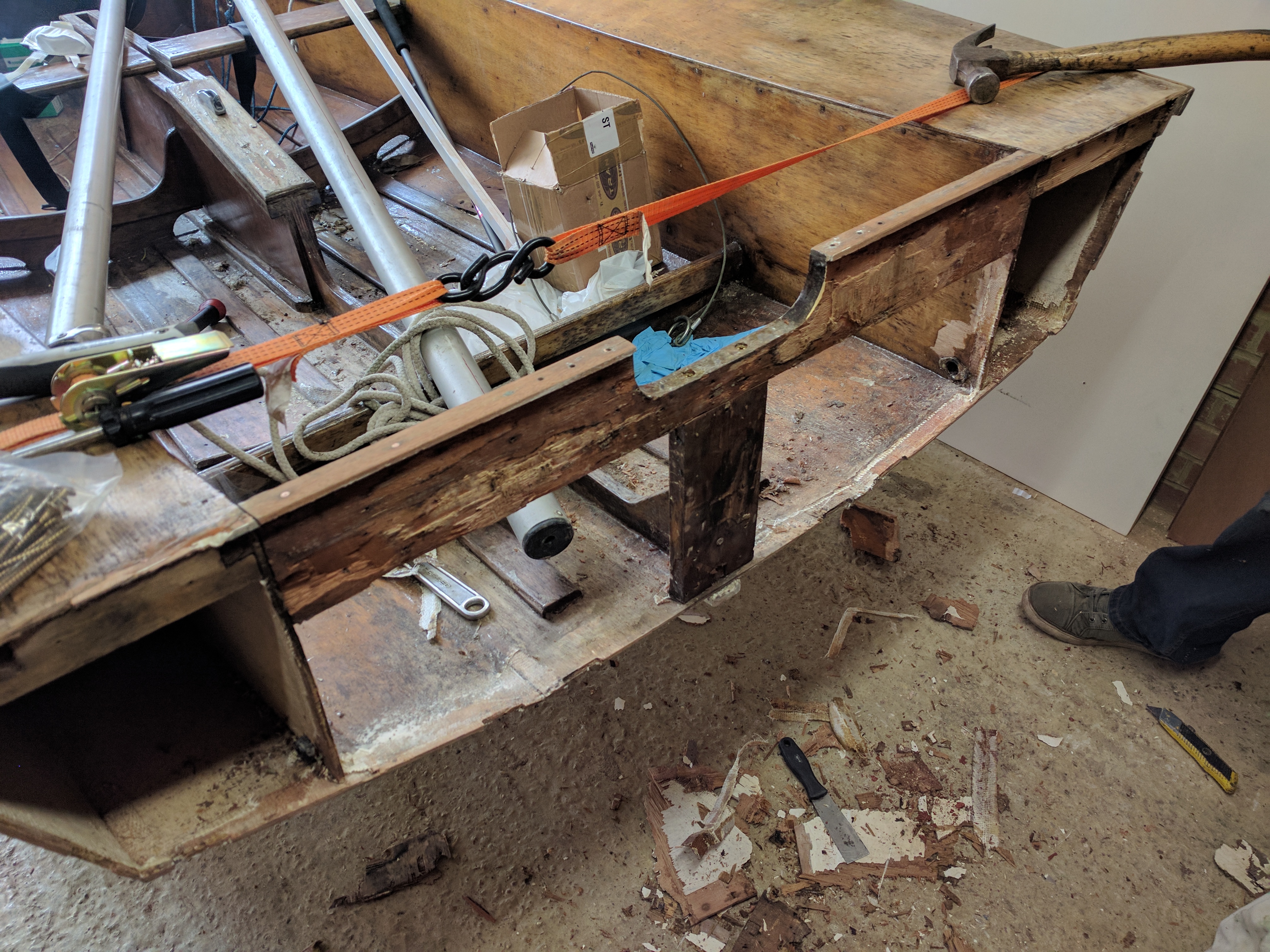

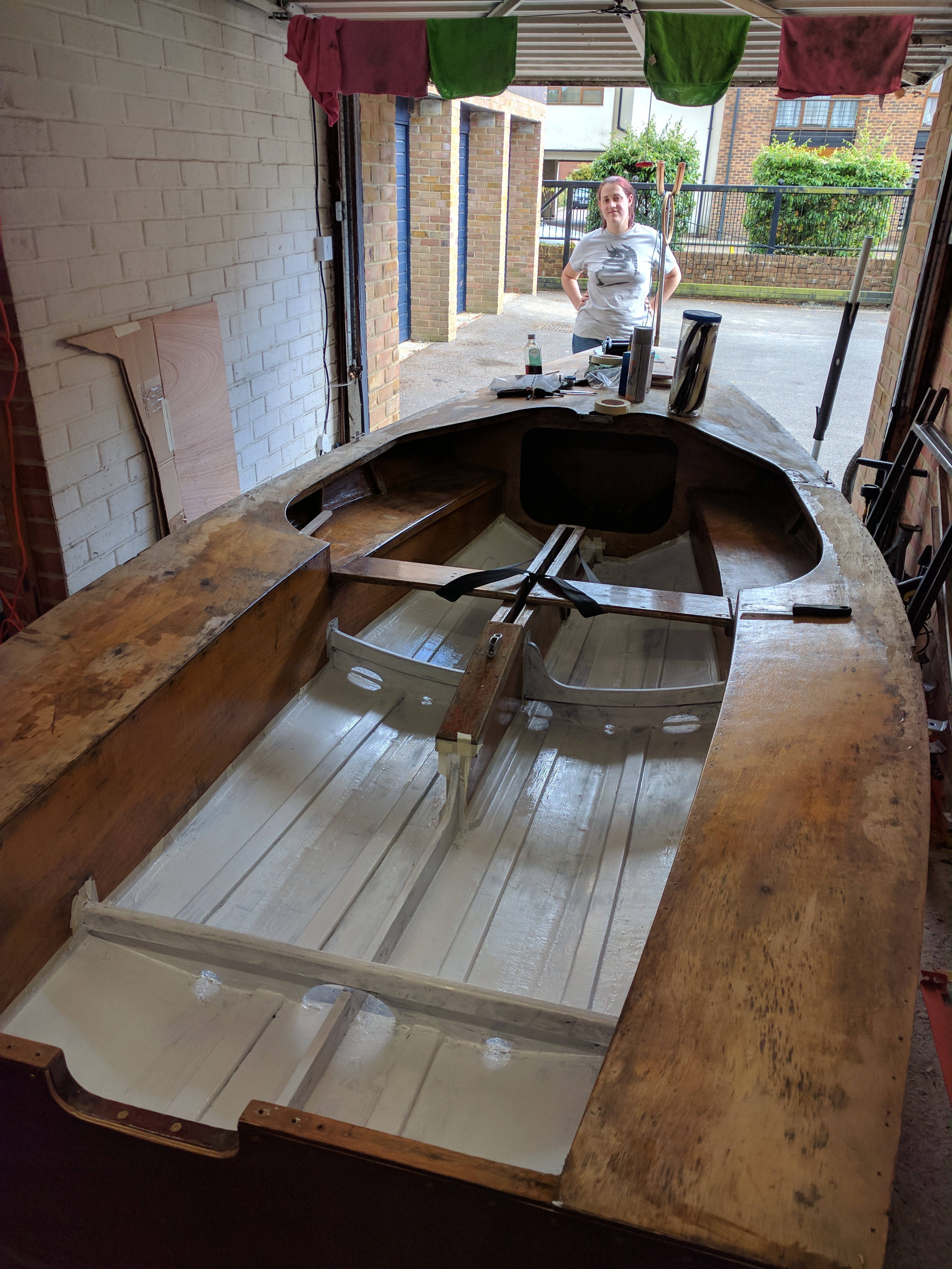

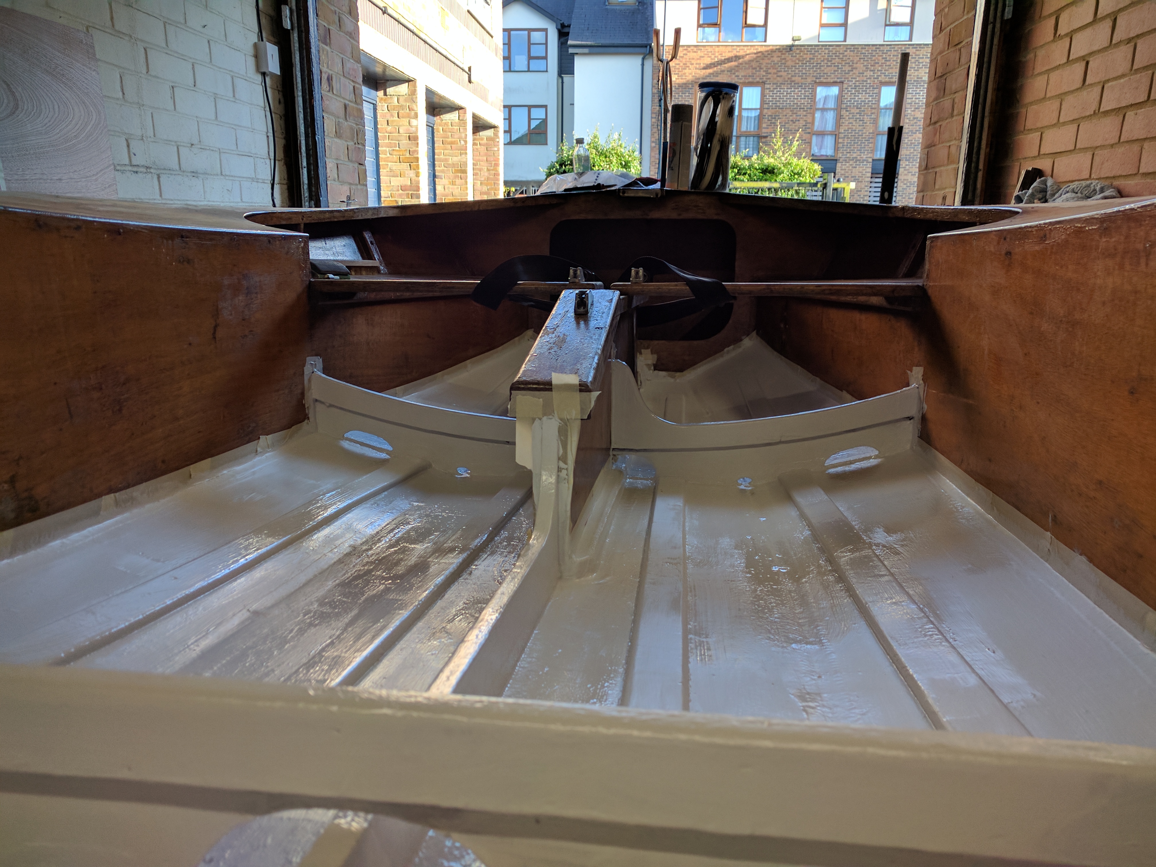

after a long while with various life crap getting in the way, the wife and i managed to get onto the business of sorting the old girl out, luckily we only found rot in the transom and duly replaced it, i also threw some extra fasteners into the decks as some of the old nails where lose in the ply. floors and bracing has received 4 coats of white marine epoxy pant with everything else being dosed with multiple coats of yacht varnish. stripping the huge number of coats of paint off the bottom of the hull was a complete nightmare but has meant that the boat has lost a lot of weight including random patches of filler that had been slapped on and painted over without fairing them in at all!! ![]() ![]() ![]() ![]() ![]() ![]() ![]() ![]() ![]() ![]() ![]() ![]() ![]() ![]() |
