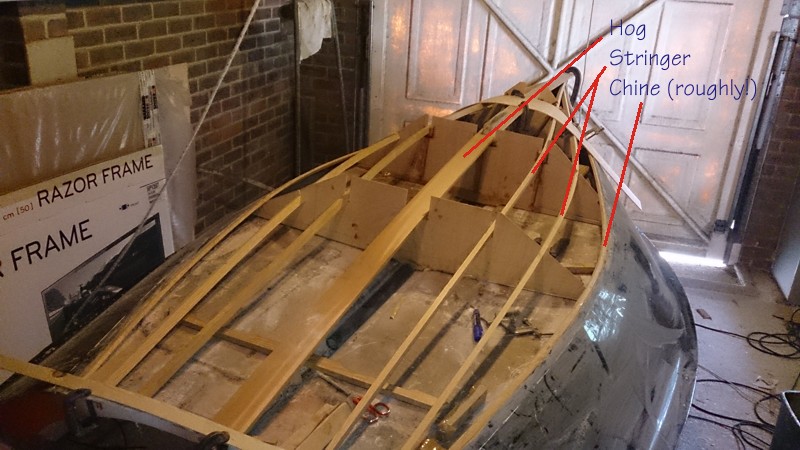

Clinker's a damn silly way to build a boat in the 21st century: exceeded only by fake clinker... You could make a kind of argument for a pseudo clinker where joins between panels on stringers are overlapped rather than butted to avoid butt joints but still minimise end grain exposure, but you'd regret it as soon as you got on to fairing and painting the bottom...
I've been rebuilding a Moth with semi cold moulded panels. There are two stringers between "chine" and hog, and in some ways really would have been a lot more sensible to do them as separate chines, but the only trouble would be all the butt joints. The strongest advice I can give is always work from the centre to the edge and always have three edges of the panel unconstrained so they are trimmed later rather than try and make them fit. Multiply this advice a hundred times if the panels are heavily curved.
I really strongly advise using glue. Look into the foaming urethane glues, they are far less hassle than epoxy if not quite as friendly to approximate carpenters. I can't see a boat with mechanical fasteners only working unless its just ridiculously heavy. Nails will just get looser and looser.
Edited by JimC - 05 Dec 14 at 12:26pm
Posts: 6499
Post Options Post Options   Quote iGRF Quote  Post ReplyReply Direct Link To This Post Posted: 05 Dec 14 at 12:34pm
I can see I'm going to need to know these terms, chine I know 'hog' which bit is that? I've also heard the term 'hog' stepped when used to describe masts so is that the deck or the base near the keel?
Also I thought those new wonder of the age plastic nails kind of melted into whatever they are driven into, either way I'd only use them as 'tacks' then epoxy tape after.. I guess, it's all new territory this having to do it yourself rather than instruct someone else poor pensioner stuff.
Post Options Post Options   Quote JimC Quote  Post ReplyReply Direct Link To This Post Posted: 05 Dec 14 at 12:48pm
Hog is the strip down the middle of the boat.
I'm never really convinced by tape joins. I suppose I've seen too many leaky side tank to floor joins over the years, endlessly replaced and leaking again two weeks later... I think the trouble is that there's not that much stopping the seam opening. They're a valuable addition to glued joints, but not in my opinion a substitute.
