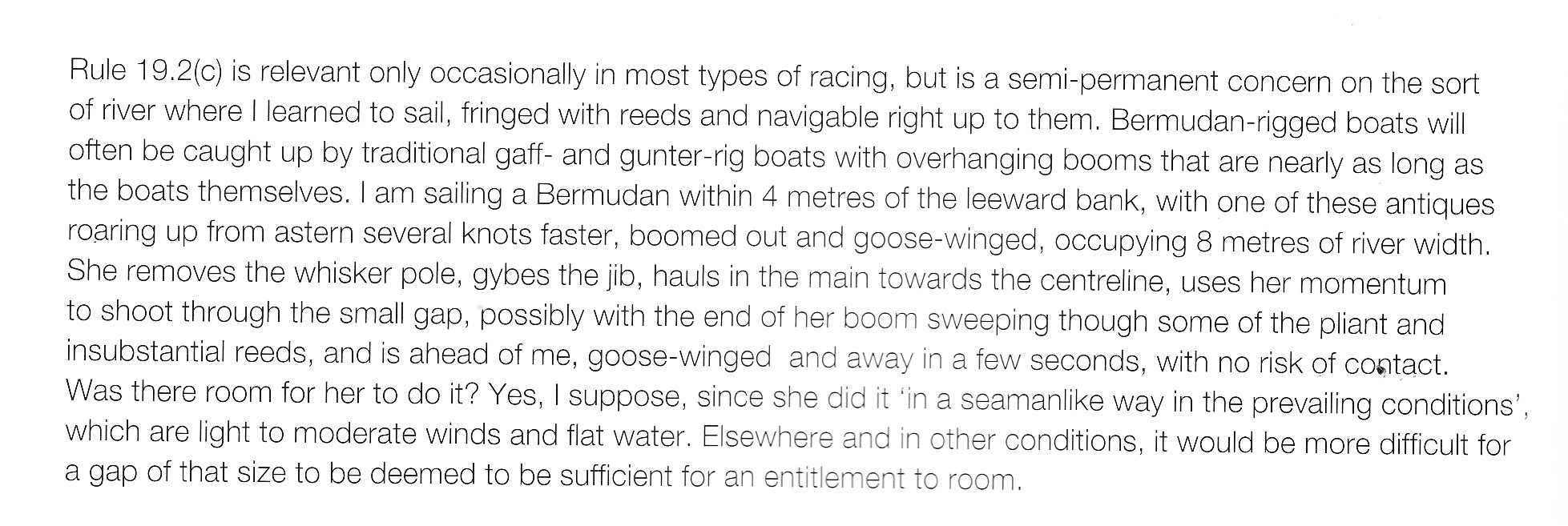

Originally posted by Brass
This quote from Trevor Lewis The Racing Rules Explained (2009) is, at least, interesting
So I guess that this also applies to my "rudder half up" suggestion ... in wild conditions or in a heavy boat this might not be considered to be seamanlike (albiet subjective since it depends on the skill set of the sailor), but in lighter winds this would be ok ... sounds like this could turn into a game of chicken!

Post Options Post Options   Quote Brass Quote  Post ReplyReply Direct Link To This Post Posted: 29 Sep 14 at 11:22pm
The 'seamanlike way' test in the definition of room is NOT subjective.
It is that which is decided by a 'jury of your peers', the protest committee, to be the seamanlike handling of a hypothetical boat of the same characteristics as your own, in the existing conditions, that can reasonably be expected from a competent, but not expert, crew of the appropriate number for the boat (Case 103).
I don't think it can be described as a 'game of chicken':  there is no risk on the outside boat:  if it's close, the risk is on the inside boat.
Originally posted by Rupert
Now, being on the ball and skilled enough to lift the rudder while sailing a few feet from the shore on one side while catching up with a boat on the other, without slowing down (or no overlap) or veering off course (crunch) would seem to take a fair amount of skill? Certainly not something I've ever tried, even in my many years of river sailing.
Nice work if you can do it, but once you've got in there pond-skater-wise, you can't jam your foils down and demand that the outside boat goes out and gives you more room:  what was seamanlike to establish your entitlement to room has to continue to be seamanlike in taking the room to which you are entitled.
