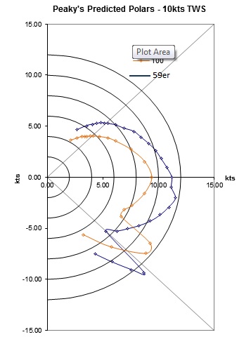

Post Options Post Options   Quote Guests Quote  Post ReplyReply Direct Link To This Post Posted: 05 Sep 13 at 5:13pm
Here is a fairly rough stab at theoretical polars for a couple of boats in 10kts of wind. Best upwind VMG is where the curve is at its highest (about 42 degrees for the 59er, 45 degs for the 100).
Edited by Peaky - 05 Sep 13 at 5:13pm
