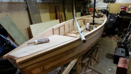

Thanks for all the reply's. A lot of good, useful information.
So to fill in some of the blanks.
The boat in question is a new build, but something that will probably spend most of its life hanging in the roof of the garage.
Its a variation on a West Mersia Duckpunt, made famous by the exploits of Dylon Winter.
Mines made of a thinner ply but I've added buoyancy tanks front and rear to add a little stiffness but more importantly some safety for when I am bobbing up and down on the Medway.
Based on everyone's comments I'm going to seal it all with the pond sealer (see separate thread) and then use the Sikaflex to fillet with. The fillets don't need to be big but I want to seal all the odd gaps to make it look better and to reduce the number of places water can seep into and rot.
I'll let you know how it works out
Ian

My interest is only in the ability to sail in 6" of water.
Ian
