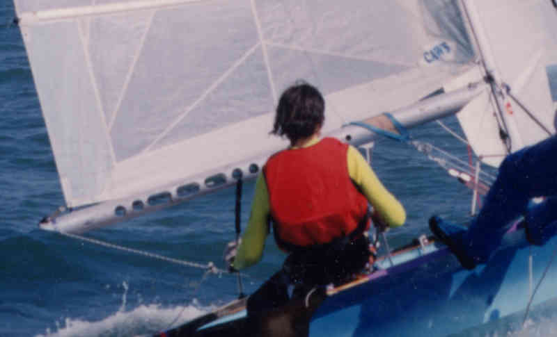

Post Options Post Options   Quote JimC Quote  Post ReplyReply Direct Link To This Post Posted: 26 Jan 13 at 8:18am
Originally posted by tick
I am going to make a new round ally boom... As far as I can see the tube will cost about £25.00
It not quite that simple. There's alloy tube and alloy tube. Dinghy metal spars are made from a high spec alloy which I think is also specially heat treated. Straightforward aluminium tube from a metal stock holder isn't, so its much less stiff.
That doesn't mean that you can't use it: I've done it, but it does mean you have to go up quite a bit in section in order to get the same results. It also means that you need to be very careful about how fittings attach and where you put rivet holes and so on. It will also be heavy because of the larger section, but if you are keen you can cut holes in the lower loaded areas.
Here, as they say, is one I made earlier...
Edited by JimC - 26 Jan 13 at 8:21am
