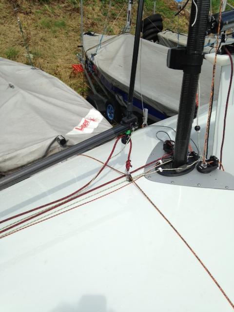

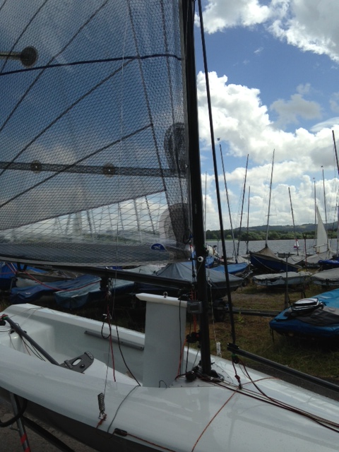

Not sure I would recommend it, but I've seen this set up on a K1:
Not fitted here James, but imagine jib cleats fitted on the spine fwd of the board.

Hmm, not at all sure about that K1 arrangement. Might be the worst of all worlds! I've just had a thought about what might be a way to do the extended spar kicker arrangement without a line going right up the jib... Must do some sketches!

That K1 set up looks all wrong.... I think I'd rather just go for old fashioned Laser2 type fittings!
