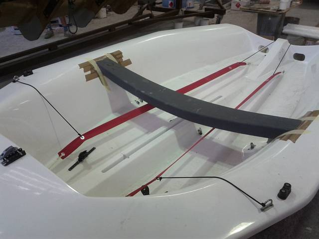

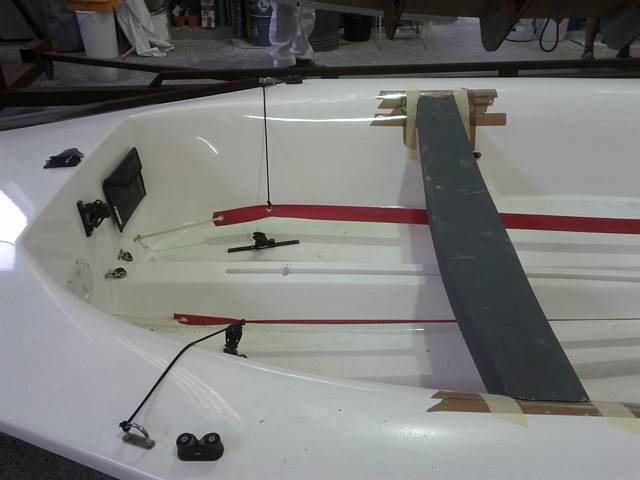

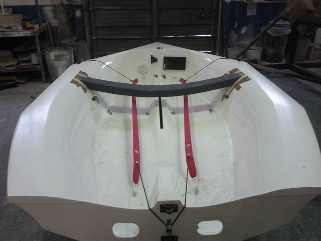

Spied earlier today:
![]() ![]() ![]() More detail to be added including a centre support. Mike B. |
Icon 04
Blaze 840 "Ate For Tea" |
Sorry, that just looks plain wrong. The crew will get banned from sitting on it in light winds because it is too far aft, so they will end up crouching anyway.
Hi Rupert ...
You need to know Icon ... or be at the factory. It may be perspective issues at play here anyway as the 'gap' between shroud and thwart is just big enough for the crew... It is long cockpit on a largish boat and maybe you are subconsciously seeing it as say N12 length (Icon is not far off 15' !) ... you need to add getting on for half a metre+ for a start. The first photo might make it look too far forward .... while the third one 'places' it well aft. Besides the actual location is pretty flexible. It is being bonded in with polysuphide mastic on a pad and you could put it further forward or back - tolerance is there and it is partly customer choice . The pics look like they show a development plug just resting across the boat .. and remember a thwart is only an option for those who want one .... not standard equipment. Mike L. |
rb_stretch ![]() Really should get out more ![]() Joined: 23 Aug 10 Online Status: Offline Posts: 742 |
Well from my perspective the thwart does make the Icon a more desirable boat for a whole host of reasons. In actual fact I ended up with an Albacore because I needed a thwart, but also because I wanted to wait to see how the Icon shaped up as a class (unfortunately I have been burnt in the past by being an early adopter, so won't go down that path again).
It might be that the shroud base is a long way aft of the foredeck, I guess. I like the idea that it can be mounted where you want it - the advantage of parallel side decks?
