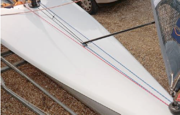

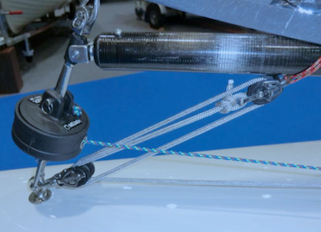

In fact the K1 does have a jib stick as well as a boom complete with its own kicker and it furls !
If you want a reaching sail then size and material on that setup could be good. Scale up from jib/genoa/code zero asymmetric.

that's a nice little system - thanks for posting.

I had that on the V2 instead of a self tacking jib track, still got it, didn't much like it.

The K1 jib kicker as shown in the photo does not work as well as it should. When the jib is sheeted out, the various links between the deck and the jib "collapse" when the kicker is on hard, so the kicker is not doing its job efficiently.
Because of this, K1's are now allowed a dangly pole (after much discussion and testing during the year). So you can have a dangly pole and a jib boom. Also, some of the sailors have the dangly pole attached to the aft end of the jib boom with a tiller extension joint.
Perhaps somebody with experience of dangly poles could comment on loss of efficiency, due to wind age, when going upwind? In other words is the advantage downwind worth the loss upwind?

Seems like a lot of scaffolding for a little sail... If it doesn't work...
Why doesn't this sort of issue get ironed out in beta testing?

I was referring to the lower of the two pictures.
The extra pole in the upper picture was the alternative way of keeping the jib boom out before the dangly pole was allowed.
