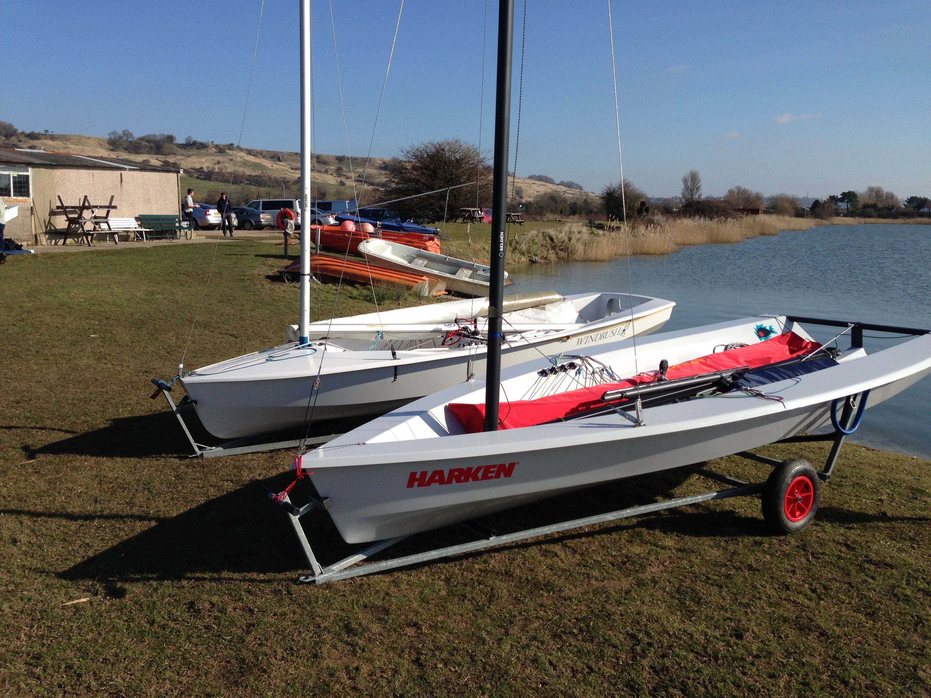

Well it's because it feels so girly lacking in power compared to my 9.4 soft sail with the huge belly that now drives the EPS, centrally sheeted with the pulley right at the front with quite heavy sheet loads, so I was probably overpowered but it didn't feel like it. I also note in that video that I was up on my ear, yet I didn't think i was at that point so it needs some customisation. It's got a really flat sail even in the gusts I never ever felt threatened by it and I had a couple of long fast planing reaches where I'd have been doing one in the EPS, but it was all calm and collected in this tool.
I wasn't talking about the Aero simon I was referring to the RS500 which I bought new, and the RS100, they were both easier to rig, more muppet proof, this strikes me as a proper sailors tool, not really a beginner boat more a refined device for a purpose and that is close quarter racing inland with underwater obstacles. Which makes it a much more versatile boat than the aero imv certainly more pleasant to sail without any of that fighting to keep it in the groove you get with the Aero.
It was and remains a silly marketing error calling it a lightweights boat, nobody calls a solo a lightweights boat and this is bigger. I had them side by side and if anything it is a more modern equivalent of a solo.
