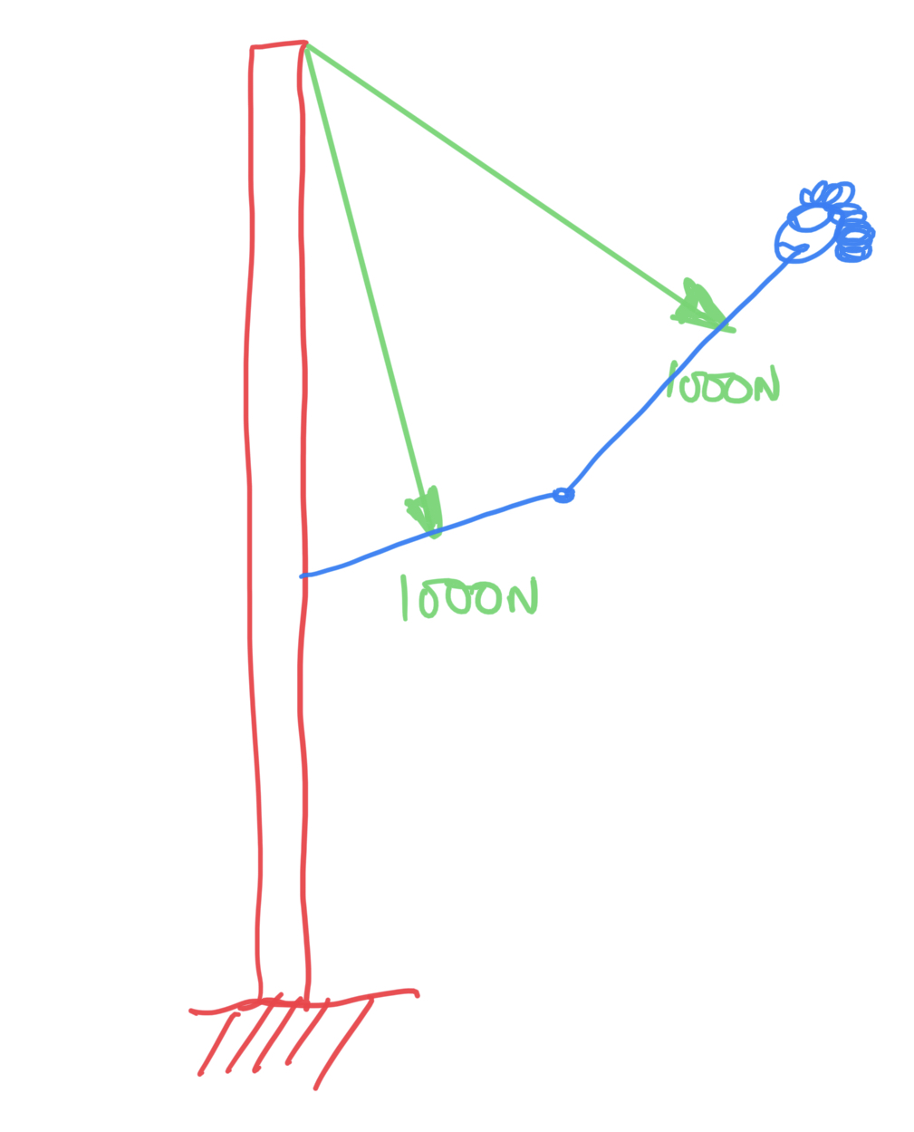

the tension (1000N) on the two examples above aren't the same.
Increasing the height of the hook puts more weight on feet and less on the wire. |

But still exactly the same hanging off the boat?

In the diagram above, there is no net horizontal or vertical force and no net moment around the mast base in either case. In a boat the moment is balanced by the sail force / hull couple. In the diagram the moment is resisted by the mast base itself. The difference in tensions in the wires is irrelevant and can be calculated just basic trig and remembering that net forces and moments at any point must be zero if there is no net acceleration at that point.

Surely the forces are there but as the are perfectly balanced they create no movement, the tree roots are easily capable of balancing the mass of the 'sailor' so the force on them does not generate movement on the trunk. In a boat the force doing the 'pulling over is the power of the rig and the force doing the 'holding up' is the weight of the sailor, the analogy is not perfect as, because the boat can heel, they need to be in perfect balance. The position of the harness hook is still irrelevant though (excepting the physical effects on the crew Mozzy mentions)

The basics remain the same. In simple mechanics with no significant member deflections, for no accelerations (linear or rotational), the net forces and moments at any point must be zero. In the tree analogy the tree reacts against the over turning moment by spreading the loads out through it's root system.
If you want to make it more accurate by considering member deflections, teh system becomes much more complicated to calculate but fundamentally the overall system remains in static equilibrium.
