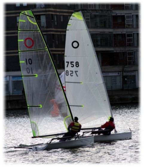

Of course I'm going to respond !!..... Both are good boats, and I've sailed both but now build the one I prefer as an all-round performer ... for me. But we are all different so best to try out the two yourself.
Many Blazes these days sheet 'off boom' - this significantly speeds up tacking and the old centre-main set-up meant you could be further back down the boat than was optimum when tacking. This meant many helms were digging the stern in and over-using the rudder to clear the extension. There are many other benefits as well but that is the 'tacking' advantage. It takes just 40 minutes to convert one .... The Blaze is exceptionally potent when it blows because of the fantastic leverage available but don't write them off in lighter stuff ... and of course if you are larger than avarage you can also try the HALO rig. We recommend 1027 for it (so similar to a Phantom now) and the additonal area can make a huge huge difference in the light stuff. However if you are sub 80-85 kg forget Halo imho and stick to the standard Blaze rig. My view is that the ideal weight for Halo is 95kg+ cos you NEED the crew weight. I've not sailed the Halo rig at a restricted river location but I suspect Halo would also be very effective indeed - 1) It is a tall rig 2) Pleanty of sail area 3) Lots of leverage If/when it does get up a bit. The nearest to 'river' sailing with the rig was last years 'Battle of the Classes' race - I was using a Halo rig and was started behind the 2 phantoms but split them by the end. Similarly at last years 'Beastie' Halo was started a minute or so behind the Phantoms but was I think through 50+% by the end. Still it does not matter what we think on the forum ... its what you might feel after trying for yourself - good luck whichever way you go. Contact both CA's and ask to try. Mike L. ![]() Edited by blaze720 - 08 Mar 11 at 7:15pm |

Yeah but you never got near me and coastbuster did you Mike? Both have their merits and to be honest Mike and I will always lean towards our respective boats. Ain't a blaze too wide for a river? I know that if it was always windy and plenty of water I would probably go for a blaze, but it ain't like that in a lot of places and the phantom seems to me a better allrounder for wind and venue
