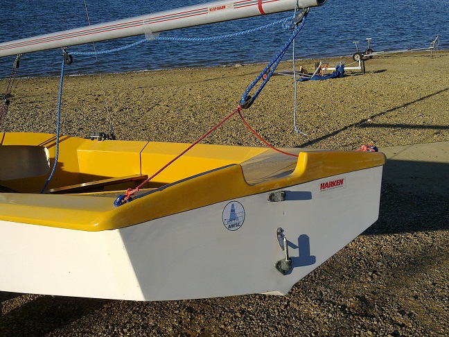

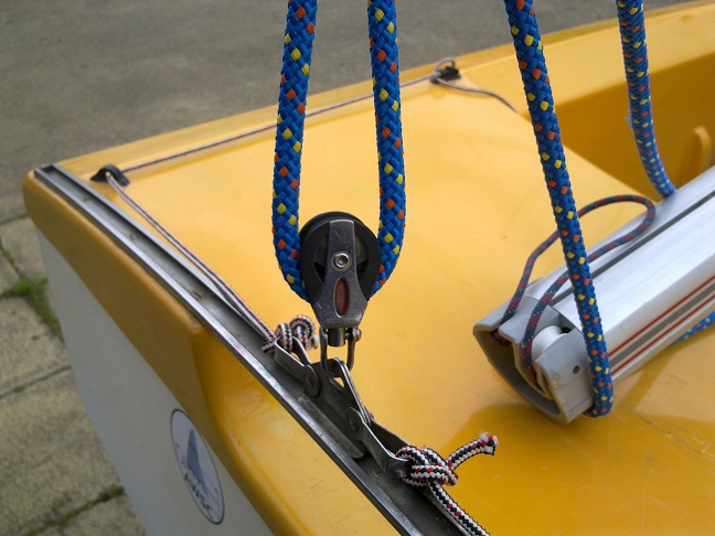

I would ask this question on the Graduate forum but a) it's a bit quiet on there and b) it's a fairly general question: Our ancient Super Grad came with a stern mounted traveller, however most Graduates seem to use a simple bridle/horse arrangement so I converted mine to that format. Aesthetically the boat looks a bit weird without the traveller because it was obviously designed to have one and I'm tempted to reinstall it. What are the advantages of using the traveller ? and how would we use it ? (the previous owner had locked the traveller at the centre and left it there. As I'm new to sailing 'double-handers' I don't want to find myself with too many controls, especially if they don't offer any advantages. Just in case it's relevant we use off the boom sheeting with a 40mm Harken ratchet mounted on the boom, Many thanks in advance, Nigel ![]() |

Travellers date back to the old days before really efficient kickers when the mainsail leech tension and mast bend was controlled by the mainsheet. The idea was that you could let the traveller run out in higher winds so that you could sheet the main in hard whilst keeping the boom well off the centre line. OK until you get a gust and have to ease the mainsheet when the mast straightens and the sail gets fuller. So it didn't work well in practice. Most owners will have either replaced it or just left the traveller in the centre and upgraded the kicker.

From a purely retro aesthetics viewpoint I'd agree that it'd look better with the traveller back on. Just don't expect it to be anything more useful than misplaced ballast As ham4sand says it's nice grad you've got there |

Specific to the Grad, you do need to use a high bridle system in order to get the boom centrelined without causing the top batten to stall. To get the best out of the totally optional sheeting arrangements of the Grad, which can have the jib clew being brought as close as 250mm from the centreline, you need the main out of the way of the slot.
Staying with the old deck mounted traveller system would mean that the downward thrust of the sheeting would cause the top batten to stall before you got the main in enough to be out of the way of the slot.

Yup spot on... if you want it to point as well as other Grads then you have to bring the jib fair leads in... and then centering the boom, whilst not stalling the top of the sail, is essential to getting it all to work. If your sailing for fun then it doesn't matter much but if you want to race then a well set up Grad will out point just about any thing. Ian
