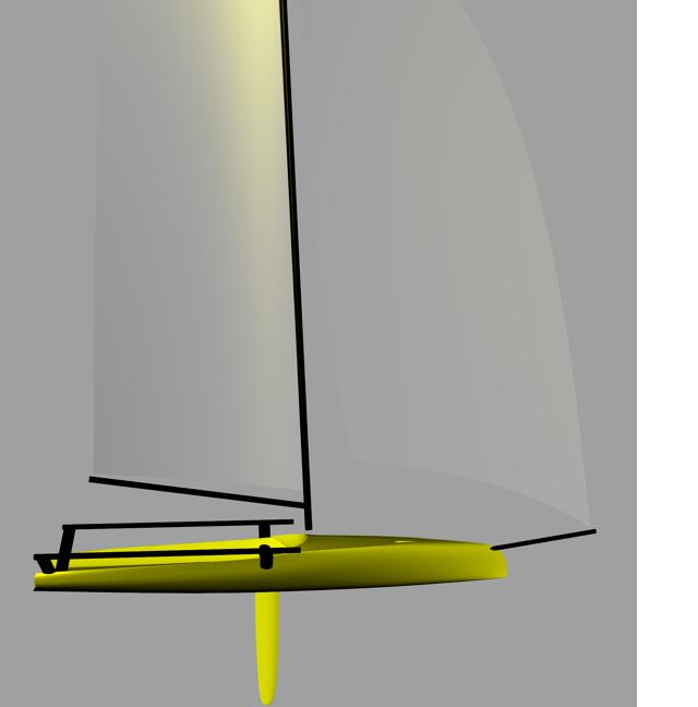

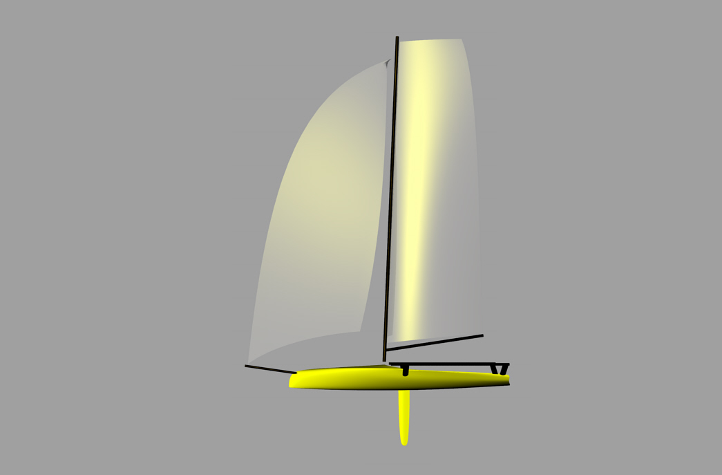

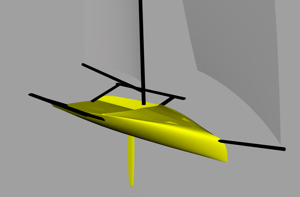

The board looks a long way forward to me. Is this correct? How does that work? Big (balanced) rudder contributing to CLR? Nice looking boat though. It's interesting to consider whether to go for a singlehander with a kite and no wire, as a route to kite and wire. Is this a better route than wire first? I expect it varies with where you sail and in how much wind, and who you want to race. I'm currently bimbling with an old RS600. |
Thanks. To be honest, it is just placed by eye in these drawings - I only spent about an hour knocking it up. I will do some more proper design on it over the weekend, and see where the board ends up then. I think there is a large number of people who don't want to trapeze helm at all - either because it is a skill too far, or the water is too restricted, because they like the pain of hiking. |
What I want to do is go to a single hander with both options.
I.E has the rack to operate with, but offers the option of entry level wiring but without the absolute necessity to wire inorder to survive round a course. To me a wire I consider like a harness, use it or not but it's a comfort option rather than a necessity for the thing to function. So I'd like to be able to get round courses without having to have it, but if the need arose and I got fed up with all that stomach aching hiking bollox, I just clip in and get a bit of support, maybe hike out a bit further off the rack. Now, what is so wrong with that? Why has it got to be either or? A higly marketable product I would have thought, it could be used inland or on the sea, introduce folk to harnesses if they want, but not an absolute necessity. Edited by G.R.F. |
I assumed that was to do with the fact it swings back and if the start point is too far back the tip inteferes with the rudder when it's pivoted back. |
