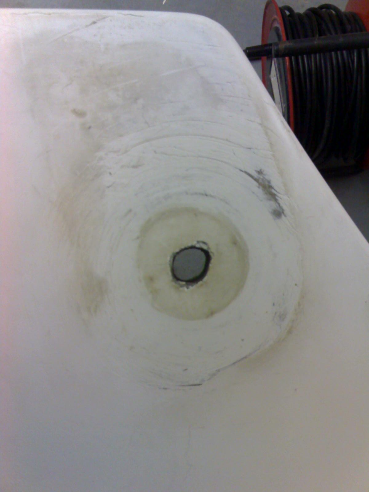

after sailing my 300 a few times and realising each time i had some weather helm unless i loosened the bolt right off, swung the rudder blade down hard until it when 'thunk' on the bottom stop and then tightening the bolt right up. if i pull it down using the downhaul rope i get HUGE amounts of weather helm.
could this be the problem? if so how do i sort it out?

measure where the centre of the hole is/should be and write it down so you dont forget. Fill the hole with epoxy mixed with microbaloons, once hard sand off any excess and drill a new hole, the correct size and in the correct position.

would it be worth enlarging the hole before filling it so that it has like a tube of this epoxy where the bolt travels through.
by epoxy i assume you meant the yellow/orange globby stuff which is impossible to sand (well slow). also, what are the microbaloons things? and where would i get them from?

Microballoons are small spheres, of varying materials. Added to an epoxy (or other resin, for that matter, but you're best off with a marine grade epoxy) they make for a good filler that's much easier to sand. However, that's where helpfulness runs out, as at work we buy them in large amounts from chemical suppliers.

Repairs for this have already been suggested. Open out the hole slightly, fill with epoxy (West & Colloidal Silica, or Sp & microballoons), then re-drill a new hole in the right place. Its also a good idea to fit a plastic tube over the bolt, if you can find one, it will help spread the load a bit and slow down future wear. Best thing to do is ease off the wing nut before you pull the rudder down and then before you get any speed up, tighten the wingnut as much as you can. When you pull the board up you'll need to ease the wingnut again.

you mean im not pulling the rope down all the way???
im not sure it is that as whenever i 'throw' the blade downwards and it thunks against the stop its fine, when i try and pull it down using the rope i get loads of weather helm. This led me to investigate.
So would this be the cause? or can i forget it and put it all back together?

The  blade must not be  allowed to  raise at all, this is where the weather helm comes from.
I had similar problem with a old RS200.
After launching and  pulling on the downhaul, I'd sail (depowered) till clear, then stretch over the stern and grab a hold of the  trailing edge of the rudder(underwater).  then, I'd gently push it  forward, to ensure it was hard against the  rudder stock. Tighten both wing-nut and  downhaul... then go sailing.
NOTE -  there used to be  a small piece inside the  stock preventing the front of the blade bashing into the stock. this was removed to enable the blade to go forward as much as possible.  i.e  If  not gentle when not  there; when lowering blade stock will cut a small groove into top of blade.

yes, the blade has that on the top. it looks as if the top layer of the foil is just peeling slightly. i was going to sort that out aswell. but thought getting the hole right was more important.
