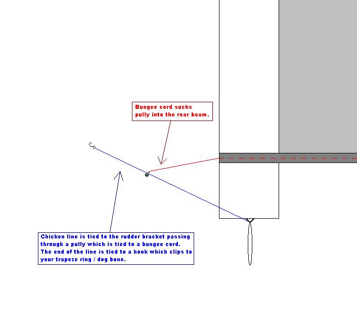

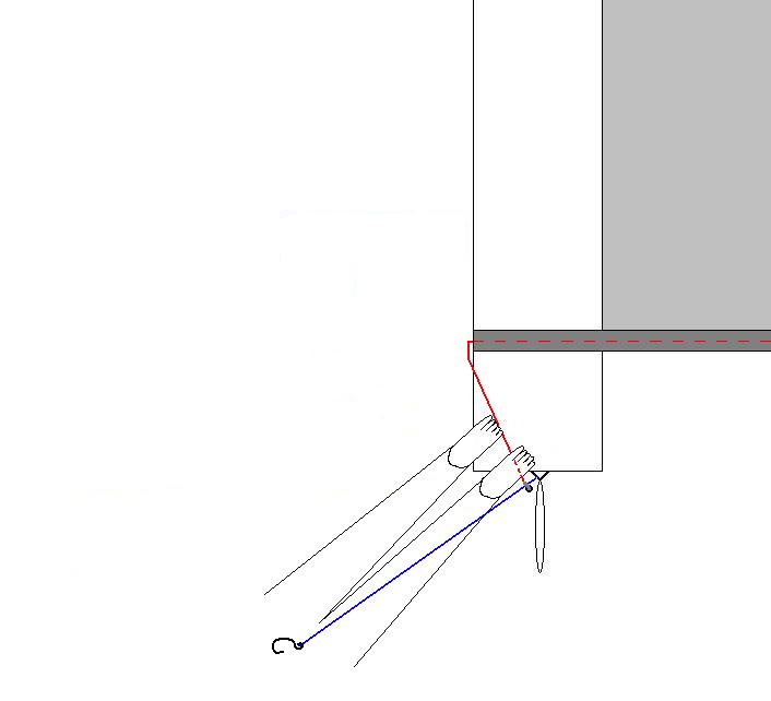

Good diagram. I can see the logic for them, don't get me wrong, I have just never had the need so never put one on. |

hi i sail a Hobie Dragoon but movin onto a Hobie 16 after getting 4th in the worlds and winning the Nationals, and also because im too big now!. Dragoons are too short to get your weight back when it really windy! so u cant really trapeze downwind because the nose goes in before the hull comes up! thats normally if it wavey but evem when its flat sometimes! i was wondering does a chickin line not leve u hanging in mid air if the boat does go over and i would not like the thought of that! Me singlehanding (do have a crew lol)

I am quiet supprised that few people in the F18 class use chicken lines. They are quiet popular in the Tornado Class. On big nose dives we have come out of foot straps. Also in the real fresh stuff, we get our back foot on the transom getting weight futher back. This is a technique we picked up from John Forbes several years ago after he saw a Euro team use it to great effect in a fresh series.
Chicken lines are for chickens ![]() ![]() ![]() On a more serious note we find that the foot loop on the back corner is enough to keep the crew on the back in a nose dive. |

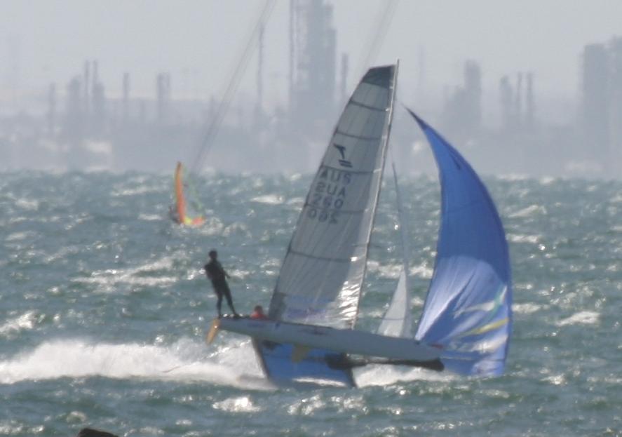

Driving a cat hard downwind is all about technique and knowing when to throttle back, just like a mono. Warning signs are also just as easy to see. Even Skiffs will throttle back in breeze sometimes bringing the skipper in and running a bit deeper. With a cat though, if you use a chicken line, when you stick a bow in, you will rearly swim if at all. Monos don't have this luxury. This is us sending it in perhaps the ride of our life in 30 knots and BIG waves. Crew got right down the back of the boat and we did not look like we were going to cartwheel.
