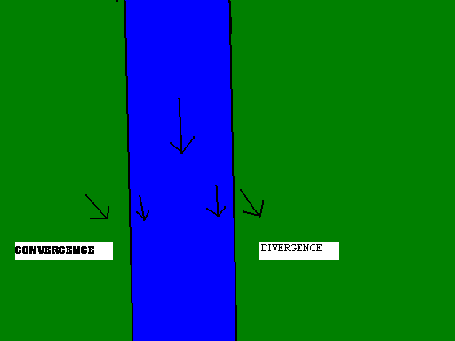

The wind flows at slightly differnet angles over open water compared to the land.
Simply this is to do with the amount of drag that the surface creates.
Also at higher altitudes the wind is at yet another angle. This is a similar direction to that of the isobars on water charts.
As the wind closer to the ground gets slowed down by friction it changes angle (consevation of angular momentum) and the direction is controlled by the turn of the earth (corriolis effect) in the northern hemisphere this slower wind turns to the right.
Since the wind flowing along a bank is slowed more then the wind flowing along the water the wind on the bank is turned to the right meaning that this wind colides with the wind flowing along the river causing convergence and a similar thing happens on the right hand bank where the wind is turned to the right which means it flows inland more causeing a divergence in wind.
Not only does convergence mean a strengthening in the wind but it also changes the direction slightly so that you will get headed as you come into a left hand bank but will be lifted away from it (in stronger winds)
Similarly divergence lessens the wind strength but can provide you with a lift as you aproach the bank.

Hmm, I'm beginning to regret starting this   , but think you are on to something with the wind turning in the same relative direction (and like the diagram too).
According to a 505 web ref the opposite is true in the southern hemishere....
So the story so far, based on the above diagram -  something causes the wind on the left bank to turn right and flow towards the water (perhaps friction / difference in speed/pressure between it and the wind over the water, Coriolis effect) giving convergence, and something (the same effect) causes the faster wind on the right side of the course to deflect to the bank to join the slower wind over the right shore giving divergence. The something is the Coriolis effect which is acting on winds when they change speed  or not
