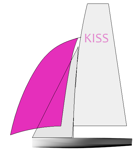

Anyone got one? Will GRF do a V3? Will JimC move on to a C#? Will KneeWrecker put a trapeze on a lurid colour Phantom?

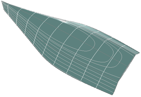

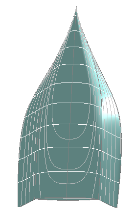

Here's mine. Nothing will come of it, but it's warmer than real sailing! ![]() ![]() ![]() Edited by Peaky - 24 Nov 14 at 11:01pm |

Hi Peaky
'KISS' looks amazingly like an Icon ... with a few 'extras'. Well we would like the look of it of course. What are the rig / sail plan sizes you have in mind .... ? .. and a trapeze or still a hiker ? ![]() |
Hi Mike,
Not entirely coincidence of course... I've drawn it a bit smaller than Icon - 4.25 x 1.83m with about 12m^2 of white sail on a short mast (luff length 5.2m, foot 2.25m and head 0.9m). Relatively long foot on the self tacking jib (more Tasarish than 200). Very modest kite of about 12m^2. Was thinking of ultra clean cockpit with underfloor main sheeting (or off boom), gnav and no thwart. Would like to get some soft materials on the sides where your bum goes - like car dash board stuff. Possibly bean bags for the crew! Kick up foils, with replaceable gasket module. |
Hi Peaky
Decription is a bit MG14ish in terms of size ..... I'd go off the boom, nice and KISS and no thwart but maybe an option for one. For the same reason I'd not go GNAV myself. You might struggle a bit with that ultra fine bow to pack in a decent sized chute and pole though - Guess the opening would be behind the forestay ?. The spinnaker size is about right imo.... so no trapeze option needed at that width ? Knock up foils .. hell yes. Seen too much damage to be 'vertical' purist at either end of the boat anymore (I remember your own first IOS 'adventure' with a cassette rudder btw ![]() 'Softie' material.... from memory some of the NS14s in Oz entirely covered the floor with thick pro-grip..... I'd just make detailing recesses in the mouldings so there are less 'edges' to lift. Nice ideas ... but you could just get an NS14 or Icon hull to play with and save lots of ££££ Mike L. |
