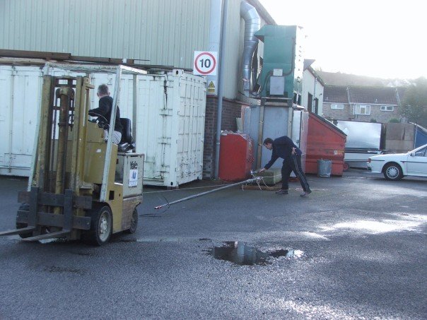

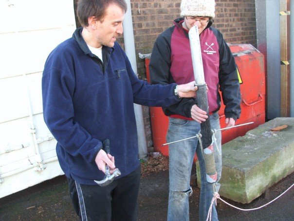

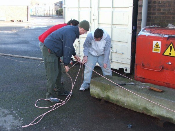

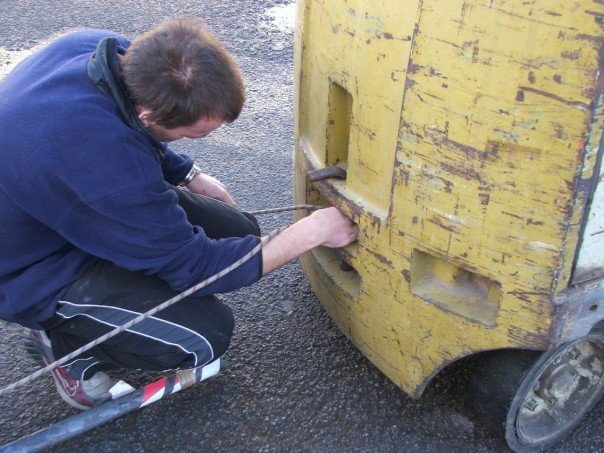

MattK ![]() Far too distracted from work ![]() ![]() Joined: 02 Feb 05 Location: United Kingdom Online Status: Offline Posts: 221 |
![]() Concrete Block ![]() Forklift ![]() Drive the forklift away from the concrete block ![]() Success
Edited by MattK - 21 Aug 14 at 11:06am |
I seem to recognise some of those people...
