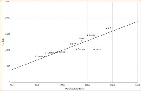

Post Options Post Options   Quote Isis Quote  Post ReplyReply Direct Link To This Post Posted: 03 May 09 at 10:24pm
Hi All
Just a quick note to say thankyou to those who responded to the original post. The dissertation goes in on Wednesday so im just putting the finishing touches on it now...
For those interested this is a comparison between my single number handicap and PY for a handfull of classes. (Il be running a few more if I can find measurement data in time)
Given the huge amount of bodging required to get something like this to work I think this has been a pretty big success and definantly shows some potential for the future...
Ive stil not been able to put my finger on why that DAMN GP14 is so fast...
