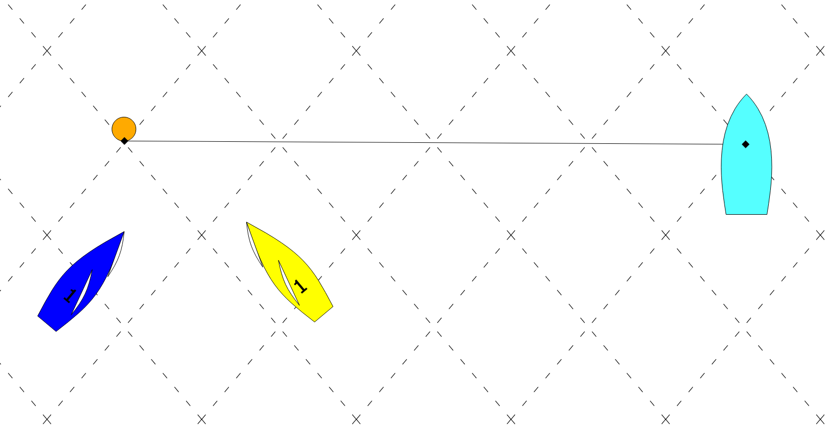

The question as I understood it was why bother with RRS18.1(a) when RRS18.1(b) would seem to do the same job. My point was that whilst that may be true at a windward mark, it may not be true at a mark on a beat that is not a windward mark - the most obvious example being a finish mark, but other examples include a passing mark on an upwind leg and a gate halfway up a beat (for example where boats have to pass through the start/finish line on each lap). In that case RRS18.1(a) still applies, but RRS18.1(b) may not, as neither boat may need to tack at the mark to sail their proper course - they may be able to just keep sailing upwind on the same tack.
So in the following example I believe RRS18.1(a) applies but RRS18.1(b) does not (assuming this is the finish line):
