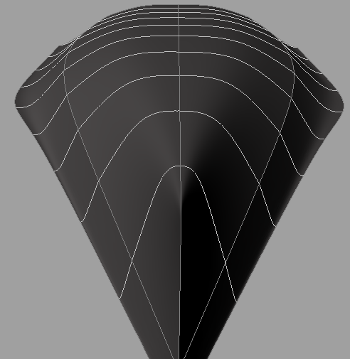

Vertical topsides, small flare fwd of the mast, big flare/wings for sitting/trapezing on.
Fast, but needs to be sailed very flat.

Originally posted by RS400atC
So all these modern boats are oly flared behind the mast, unlike the 505?
Flare in front of the mast is only really useful for keeping some spray out, which is pretty much irrelevant on a self draining boat. Any extra buoyancy isn't of value on a fast boat, because it makes it more likely to pitchpole rather than less: the boat just trips over the extra resistance it causes.
Seems to work well on a 5-oh, but there is a lack of un-flared but otherwise similar boats to compare it to. I thinking of lumpy green water rather than 'spray'.
I used to sail an old 505 in conditions where I don't think I'd have coped in much else, not having much sea experience at the time.

Funny the similarity, isnt it?! Flare fwd is prone to slow the boat down as the spray hits it, hence why 14s have very vertical topsides.

Peaky
Dead ringer from a page back .. Icon plug shot.  For all the right reasons and you will see another very similar one again when 'Echo' concept hits the water (not its real name btw !).
