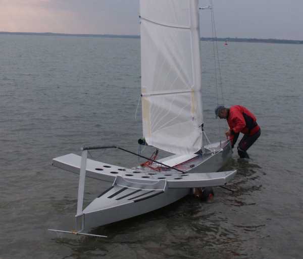

T foil rudder on my IC - at the bottom of the blade for launching ( also the rules require it to be retractable above the bottom of the transom ).  The IC at 17 feet doesn't pitch too much, nor does it nosedive like a moth, so it wasn't that useful.
The first few moth T-foils were reversible - plain one end, T-foil the other, so in light winds the idea was to have the low-drag plain end. Surprisingly, the T foil end was faster except in a real flat drift due to reduced pitching.
