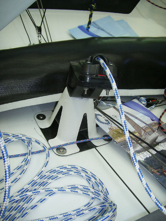

I intend to try and make a mainsheet tower for my contender, since I think I should be up to it... Any winter Cherub builders have off cuts at least 100mm x 600mm, I need enough to lay up a thickness of about 7mm, although might go for 10 as I'm not too worried about weight.

7mm wall thickness!!! are you planning on repeatedly beating said mainsheet tower with a mallet?
You may well be better of modding something like a bit of mast instead. From memory the contender towers go over the centerboard case with a slot in the middle?
how much of a gap do you need?

Isis I am going to have to slightly modify the design so want to ensure plenty of strength.

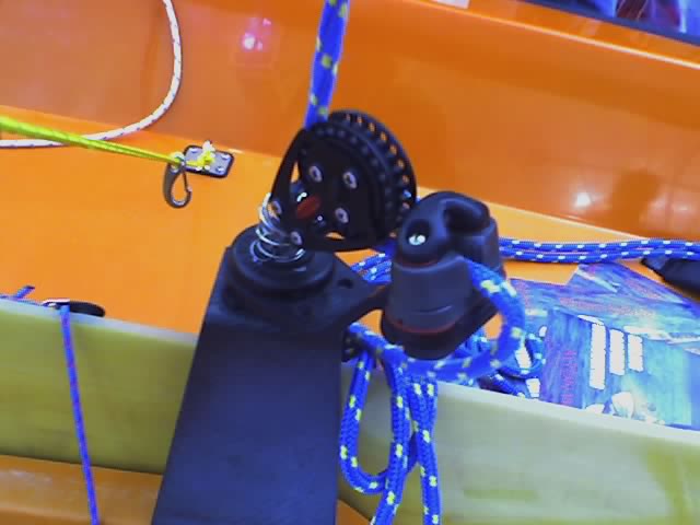

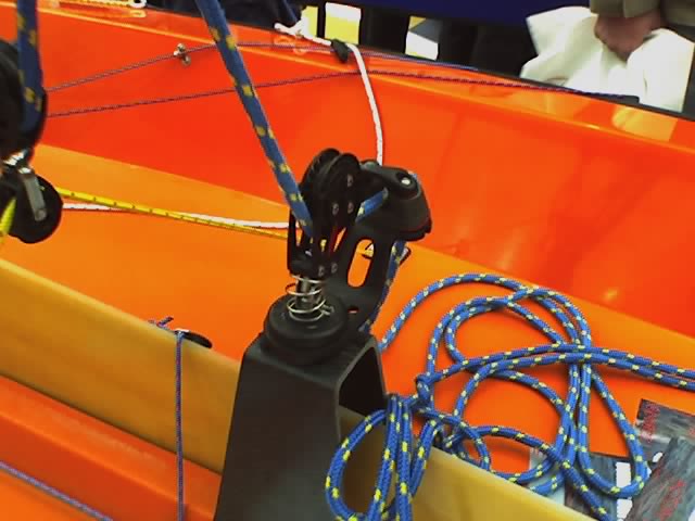

I see. I think Isis and I are going to try and make something like this:
Isis View Drop Down
Joined: 01 Sep 05
Posts: 2753
Post Options Post Options   Quote Isis Quote  Post ReplyReply Direct Link To This Post Posted: 11 Mar 06 at 6:37pm
Do or Do not... There is no try
Slightly different concept really as our swivels are supposed to be low profile and unobtrusive (as well as having the rope comming from a totaly different angle).. this needs to be tall enough to clear the centreboard when up and is balicaly just a bracket.

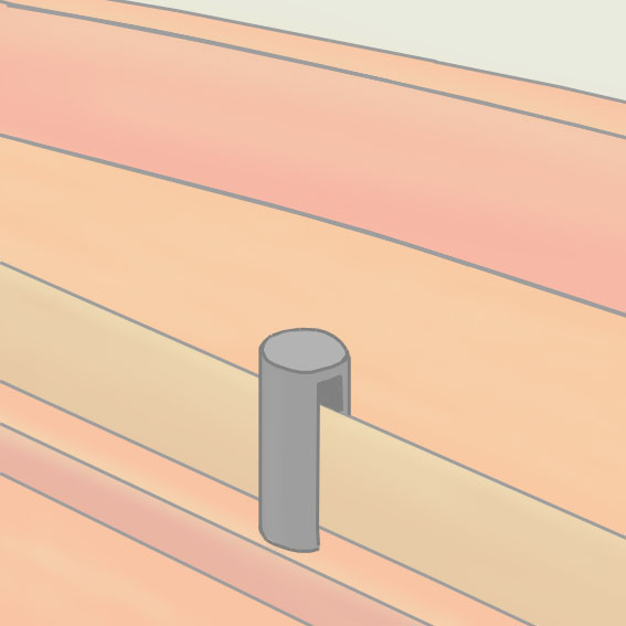

Cant help thinking you'd be better of doing something like this though if its your first time working with carbon.. saves the effort of building a mould. Bit of carbon mast/rack/pole with a slot cut through and a wooden/nylon/whatever plug in the end to mount your swivel.
No comments on sh*tty quality of artwork... im bored, but not THAT bored

Only problem I see with this is fixing it adequately to the deck and find a broken section of mast or boom to play with.

Bog it in, fillet the join and a layer of uni-d with some lightweight glass/carbon cloth on top should do the trick...
