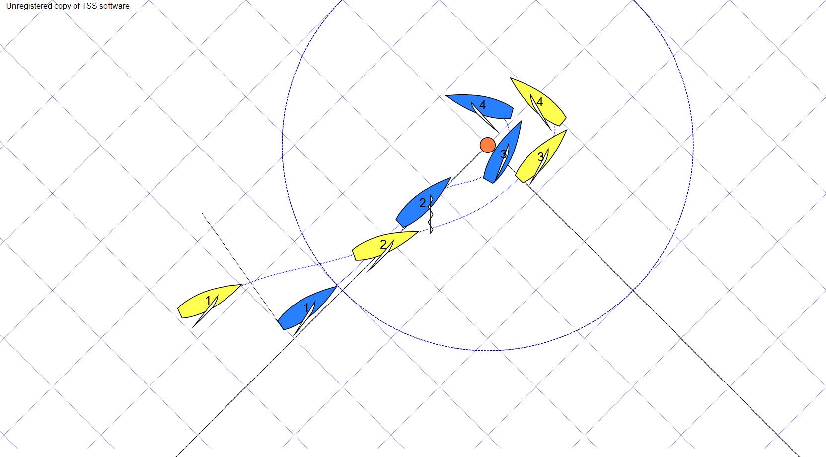

    Posted: 20 May 19 at 4:03pm
Blue (B) clear ahead of Yellow (Y) and slightly to leeward at 3 boats, both boat over the port layline on port. Proper course for both boats is to tack on the mark.
18 applies before B tacks and Y is clear astern so must give B mark room. Rule 21 exonerates B whilst sailing in her mark room for Section A plus rules 15 and 16.  But, at which point is B tacking and therefore not sailing within her mark room? And at which point are they on port and starboard and so 18 no longer applies?
Ignoring the mark the boats are going fast enough that Blue can't complete their tack and give yellow room to keep clear, so would either break 13 or 15. But as they are approaching the mark, and B was clear ahead Y should be giving blue mark room right up until position 3 (or maybe after when the tack is complete?)?
The situation could be on a tight reach to mark your course requires you to tack around or two boat over-standing a port layline.
Edited by mozzy - 24 May 19 at 10:58am
As diagrammed, B is always sailing within the mark-room to which she is entitled.
@3 + delta she will have passed head to wind and rule 18, in its entirety ceases to apply (Case 95).
@2, B is sailing in to the mark.
@3 B is sailing as necessary to round the mark.
Between @2 and @3 B is sailing within the mark-room to which she is entitled, and she can change course to round the mark as hard and as fast as she likes and will be exonerated by rule 21 if she breaks rule 16.
Between @3-delta and @3, as others have said, B can slow her turn and speed as she chooses and force Y to go around her, as long as she does not pass head to wind.
