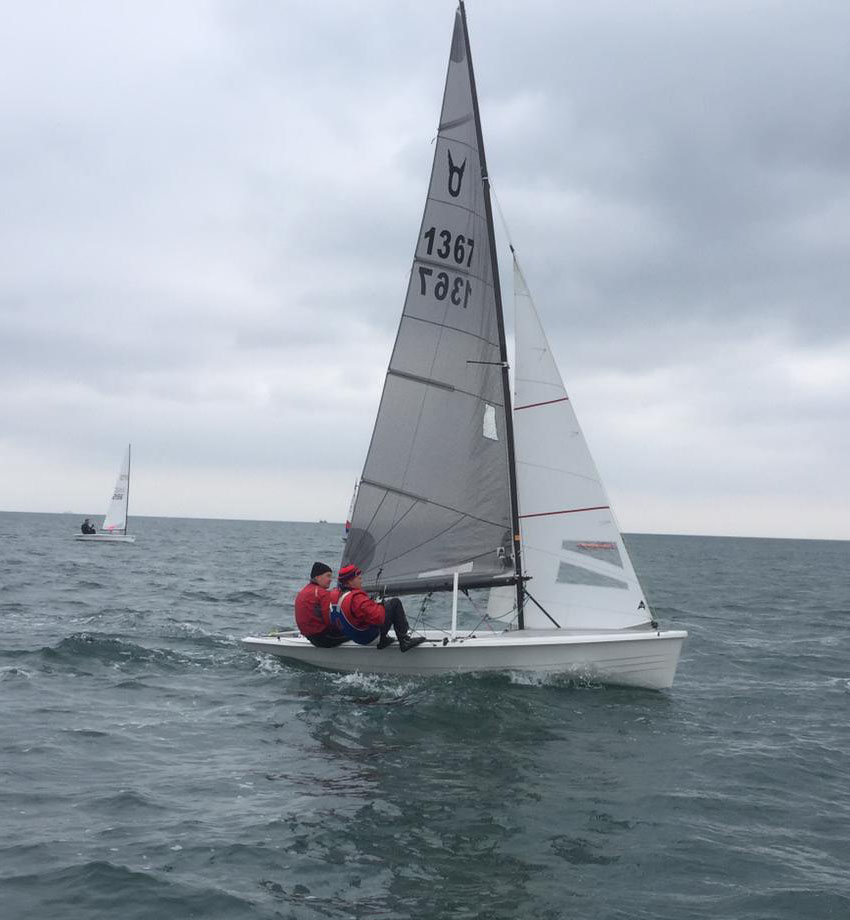

I swear by a leech tell tale on the genoa, see the window on main for crew to view the tell tale. Leech tell tales good on main as well, esp on reaches. I have camber lines on some sails, but don't use them very much. I think North Sails have a Sail Trim series, possibly of 3 books, might be worth a look. Thanks to Graeme Pinkerton for pic.
