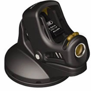

Telltale ![]() Posting king ![]() Joined: 03 May 12 Location: Cardiff Online Status: Offline Posts: 169 |
![]() Perhaps we are talking about "blocking of the lace" being cleating between hoists and "blocking when fully drawn" being when fully hoisted. In which case the above spinlock swivel cleat will do the job. As suggested by Matt. |
MattTrinder ![]() Newbie ![]() Joined: 19 Dec 11 Online Status: Offline Posts: 27 |
As used on the Xenon, one of the Boss's (distant) children. Other Topper skiffs (Buzz, Iso) etc use a standard cam cleat, with or without a fairlead on top. I prefer the standard cam cleat version, less resistance on the way up, and less likely to cleat itself when you don't want it to. |

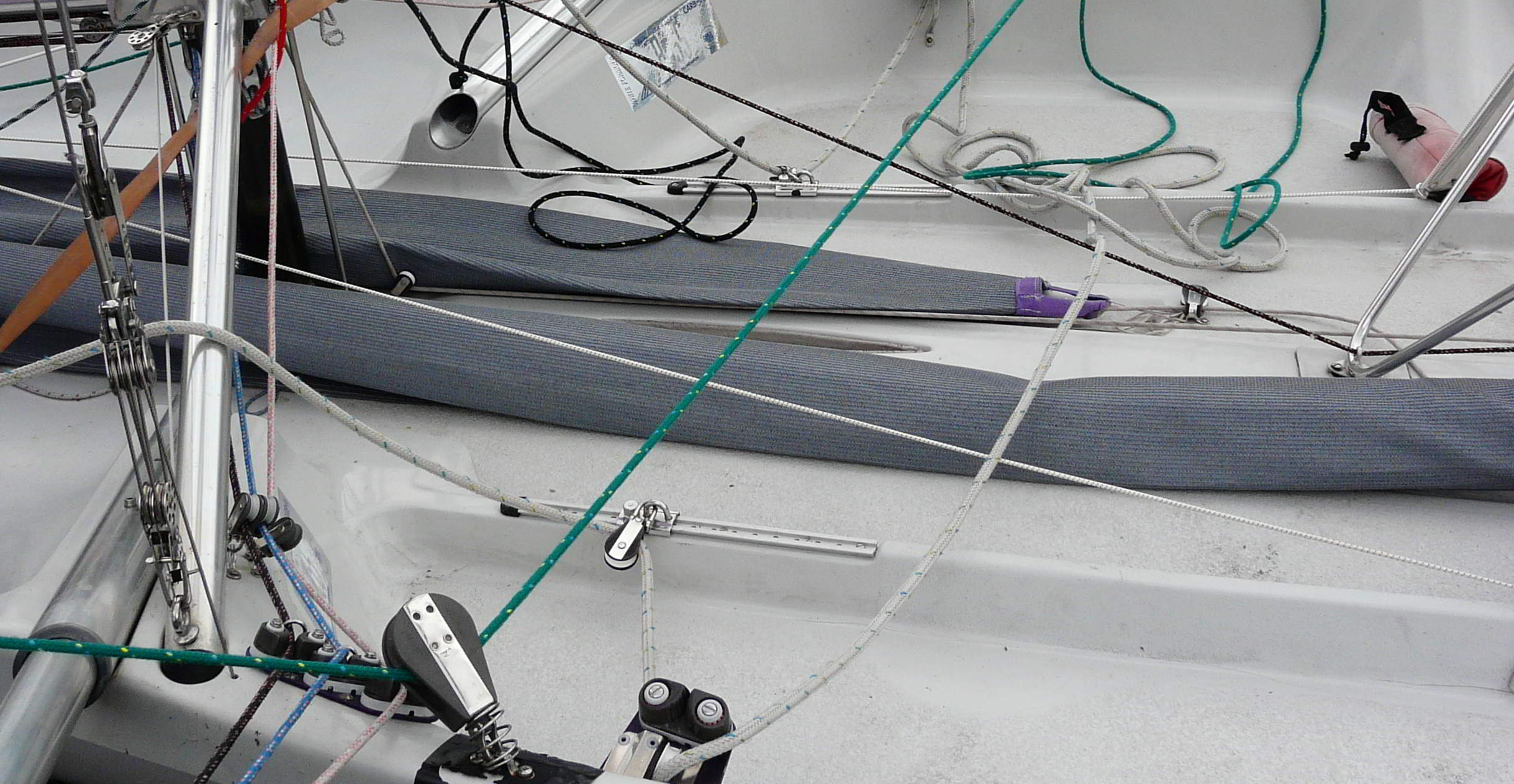

liener ![]() Newbie ![]() Joined: 24 Jun 12 Online Status: Offline Posts: 6 |
Hi guys,
many thanks for your detailed answers! For sure there is missing something! At the moment it looks like this: ![]() So it would be great, if there would be a pic of what craiggo is talking. In the mean time i'll try to get the Italian decoded!:) For sure I've something like a "circuito drizza"! Many thanks again for your answers! Cheers Linus |

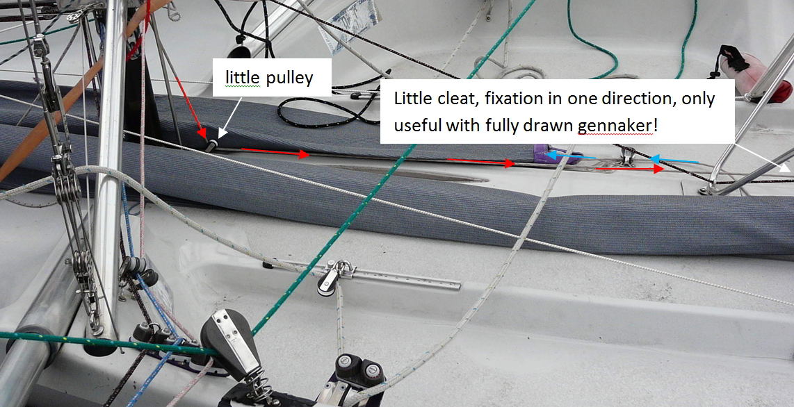

With some details:
![]() In red: Lace comming from the top of the mast, turned by the little pully. On the cockpit (not visible in this pic) there is a little cleat to keep the gennaker when fully drawn. In blue: The lace goes back through the gannaker sack onto the gennaker. It is comming from a pulley held by an elastic at the back of the boat. All in one cycle! |
