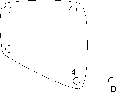

Take this as an example of the common error. All marks left to port, start and finish to be between ID and 4. ![]() You finish by touching the finish line with ID on your port side and 4 on your Starboard side, because the from the last mark, 3, to the finish line, 4, is in that direction. Which way you rounded 4 on previous laps is irrelevant. Edited by JimC - 12 Apr 12 at 3:34pm |
Ah, yes, that makes sense. In a case like that, move the finish line so ID is down screen, not across, I guess
