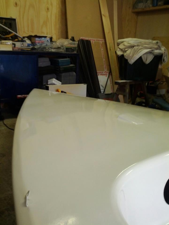

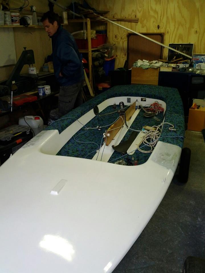

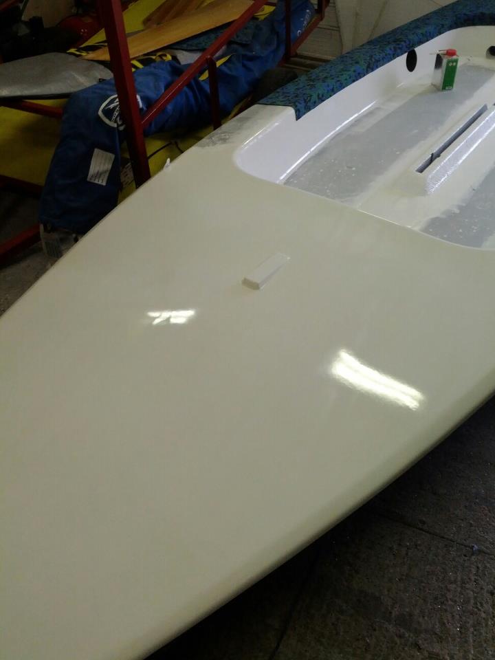

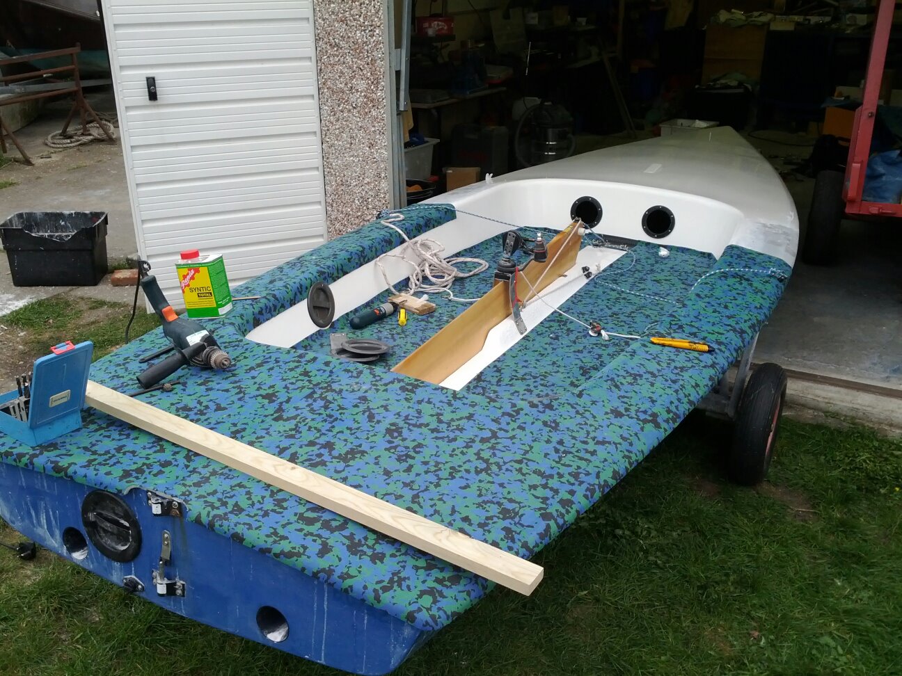

Some pictures of the contender during its winter work.
She is almost there. We have removed nearly 3Kg of gelcoat from the top deck alone, sanded all of the old embossed grip off, removed 1.5 Kg from lead I found in the hull. Another coat of paint and a little more grip and itll be there. New mast step going on as well as a few new blocks. Picking up the carbon mast next weekend, she'll be race ready for next thursday. Dan |

With that much pro-grip, you may not need the lead!
Looks good, should be fun. |
allanorton ![]() Far too distracted from work ![]() Joined: 21 Nov 05 Location: United Kingdom Online Status: Offline Posts: 228 |
That progrip will make it much nicer to sail, the added weight will make little difference. |
How do you take gel coat off neatly then reapply?
Musto Skiff and Solo sailor
I have spent hours sanding and filling then more sanding. I have applied a painted finish instead of gelcoat as its a fraction of the weight.
