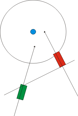

The trouble is that as soon as opposite gybes are involved a boat can be a hell of a lot further from the mark than you are and still have an overlap...
![]() Here's an extreme example: lets say the boats gybe through 90 degrees. The leader goes round the windward mark and bangs the R corner. All the other boats gybe off and bang the L corner. When the leader gybes the entire fleet, including boats that are hundreds of yards behind him, have an overlap. When he gets to the leeward mark all those boats will *still* be overlapped, so he needs to give room to any of them that are close enough to require it. Edited by JimC - 18 Apr 11 at 2:56pm |
Thanks for the drawing, thats helped me get the picture straight in my mind. Its too fine a line to call on whether I was clear of an overlap. I guess the take home message for me it to not get caught in this situation again. Useful lesson though - too often its all nice clean mark rounding. I quite appreciate a nice problem to get your head around. Just glad it was on a light wind day when everything goes that little bit slower
