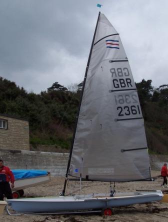

Have recently bought a new sail for my contender, however sail numbers are slightly different.
They are on a black/grey laminate sail and wondered if there was any way of removing the numbers safely? Tips tricks etc
Number is being changed from 646 to 620
A picture of the type of sail is below
