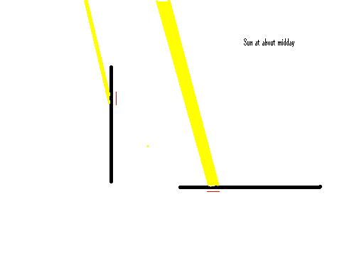

...and buy a bag for it if you aren't going to re-varnish/paint it regularly, especially if the mast is going to be 'non-vertical' (in trailing mode) for any length of time. The 'experts' reckon that a carbon mast suffers considerably more UV damage when horizontal than when vertical in the boat. (Thinks to self..."are these experts also retailers of mast bags?") |

Think about sun exposure per unit area when mast is vertical and horizontal. In fact exactly the same principle as why the equator is hotter than the poles. very rough sorry!
