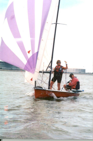

hi nice picture  well its the first time for me with a swinging pole after sailing a 5000 for six years i thought i had it sussed but this pole thing is giving the hump as i just cant get far enough away from the twos we had 7mins 30 seconds on them the toher week which was stillnot enough so we now we got the speed its just trying to work it all out.

Post Options Post Options   Quote redback Quote  Post ReplyReply Direct Link To This Post Posted: 15 Oct 08 at 1:00am
I sail a 4000 too and I think the wing-wangs are more trouble than they are worth.
In really light winds you need to encourage flow across the sails and if you wing-wang you get tempted to sail too deep and lose the flow and the kite collapses.  In medium winds, and upwards,  cleat both control lines in the middle and forget it - you'll be wanting to apparent wind sail so go high get some speed and keep the power on.  Being cleated into the middle means you can gybe without worrying about them and concentrate on what is really important.
Its just in that lightish winds where your crew has to stand in the boat that you might like to try using the wing-wangs to soak a bit deeper than otherwise possible.  But remember the 4000 hull is designed for planing and its not fast off the plane, also being a norrow bow the wing-wangs don't operate through as big an angle as the RS400 so for both these reasons you are not going to sail up to handicap if you go deep.  Perhaps that's why the 2000s keep up?  However there can be the odd tactical moment where you sacrifice speed for depth.
The real reason the 4000 has wing-wangs is that it enables the boat to carry a pole which is longer than the distance from the mast to the bow, ie long - so get it out there and head high and blast and when you gybe back you'll find you are ahead of the 2000s who have had to concentrate on soaking low and going slow.
By the way the advice earlier about letting it off to leeward to point up doesn't work, in my experience there is never any advantage in letting the thing go lower than mid-way.
The picture below shows the only sort of wind strength where you might soak low.
