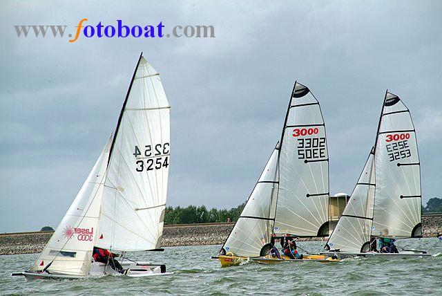

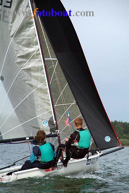

Here's a couple of photo's from last weekend's 3000 Nationals at Draycote Water showing the new North sails for the Laser 3000/V3000 dinghy: (the yellow boat's me, third overall ... "Medway Maniac" won the Nats scoring 4 bullets from 5 races in a pretty much standard Laser 3000 with Hyde sails) Having sailed a series of races against boats shod with the original Laser UK/Hyde sails, the new main and jib give only a very marginal speed advantage, the main difference is in the progressive control between going high and slower, or footing off for speed. Best VMG seemed to be when sailing freed off a little. But the ability to point high helped in gaining ground to windward of the standard Laser 3000s out of the start. The new genny didn't make a nticable difference sailing deep on a windward/leeward course, but does perform better on tight reaches. This is just my opinion. Out of interst, about a third of the fleet had converted to new class legal aft bridle with off-the-boom sheeting arrangement. The North sails are available through the new class approved builder, Vandercraft, see www.vandercraft.co.uk for contact details. Minor adjustments are needed to fit them, but I think it's well worth the effort! PS Photo's were sent to the class by Mike Shaw of Fotoboat who covered the event ... no copyright laws broken! Edited by yellowhammer |

Wow, who cares if there's only minor improvement, they look great.

It was, of course, never the intention for the new gennaker to improve the leeward Vmg. But giving it a longer luff and shorter foot (= higher aspect ratio > more thrust/sideforce) and setting it on a shorter pole was intended to make the boat a faster and better-balanced three-sail reacher on 'real world' courses that most people race on week in, week out. Talking to people, I gather that we've been successful in that. Being on the development team, I am, of course, getting my new boat after everyone else, so will have to wait to race it against other 3k's and confirm that for myself |
Being a class newbie I got my boat last week! Half an hour with a tape measure and a copy of prodesktop, then a repeat of all the measurements when the main came out smaller than laser's, still indicate: Old Jib = 2.94 sqm. Old Main = 8.6 sqm. Kite = 12.6 sqm This assumes the new sails are flat, cause including the 3d curvature is beyond my cad skills! Hence the similarity in performance. But they do look great ... and cost less. Amazing. Well done that class association! Edited by NickA |
