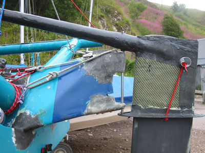

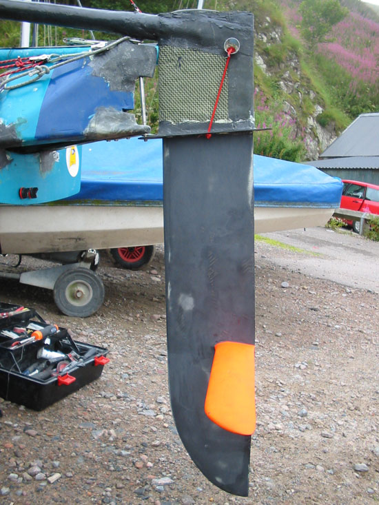

The rudder and Gantry on AquaMarina with the blade of the T fixed in the rudder, the stock rotates to change the angle of attack.
this is with the rudder almost full negative,. no lift for going down wind
The adjuster full positive for max lift when going up wind.

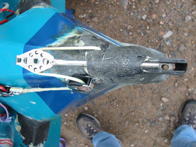

A close up of the adjuster, the rod pushes against the pintle to move the rudder stock.
One of the other ways to do it is to have the blades fo the T-foil rotate on an axle in the blade of the rudder, this is a bit trickier to make but is popular in the 14's.
