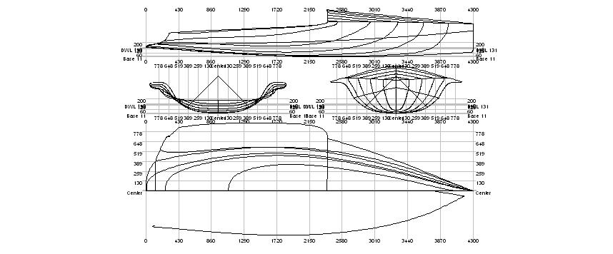

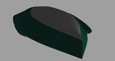

Chew my RS ![]() Really should get out more ![]() ![]() Joined: 05 Oct 05 Location: United Kingdom Online Status: Offline Posts: 790 |
Thanks for that. I've been reliably informed (by a Cherub self-builder) that Airex is the way to go as the pores are smaller and it is flexible without heating. Its a NS14, but still work in progress, especially above the waterline. |
That looks pretty severely sexy!
Is that all your own work? Impressed. Most of the mods on my boat are being built with airex (other than the snout sides which are something similar but more flexible - I forget the name) And it seems to be material of choice for most things in the cherub fleet. You could even go for something like nomex but there are quite a few issues accociated with that kinda construction (ie it breaking up if it gets saturated) |

Skiffe ![]() Far too distracted from work ![]() ![]() Joined: 24 Jun 05 Location: Australia Online Status: Offline Posts: 220 |
Looks a bit like an old Javilin hull. Sorry but it might be a bit fat. I think I still have the drawings for the first Tequila hull. If I do I'll send it to you. Are there any to race againts where you are or can you get some others? |
Thanks for the comments guys. I've not directly looked at any boat whilst designing this, but have studied the Merlin Rocket and (antipodean) Javelin websites. Also I guess my time sailing 200s and 400s must have influenced the lines. If it looks like a Feeling Foolish, it can't be so bad. Aardvark - have you ever used Airex? Your reasons for using Corecell are the same as the ones I was given for using Airex. Interesting to know how they compare. Skiffe, the Tequila drawings would be great if you've got them. There are no NS' as far as I know in the UK, so am doing this design blind. I just like the look of them and would like to sail one. I looked at importing an old one from Oz, but the cost of transport was too much, so figured I would make my own. Should be good to race against Merlin Rockets, N12s, RS2/400s etc. I think I'm right in saying that the hull rules for the NS and Javelin are very similar, hence the resemblance? As there are no others to race against, I don't mind sacrificing a bit of top end speed for controlability (but not too much!), but in what way fat? In the bow, at the stern, or all over? I won't take offence - all comments and constructive critisicm welcome. Cheers. |
The Jav was the prototype hull for the NS14, if you are desgining a NS14 then get the rules, I think they are on the net. It looks fat all over. As for transport PM strawberry he is appaerentally getting 2 12's so space shouldn't be a problem. http://www.sailinganarchy.com/forums/index.php?showtopic=344 56
