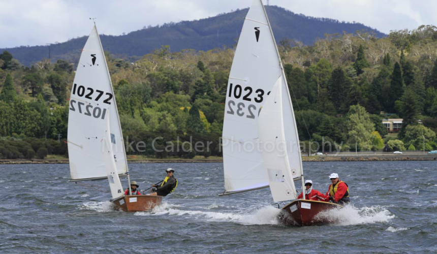

To be fair to the OP, there is an awful lot of mast bend here…..and look what’s happening to the jib luff…
Not sure this is what Jack Holt had in mind at the design stage
