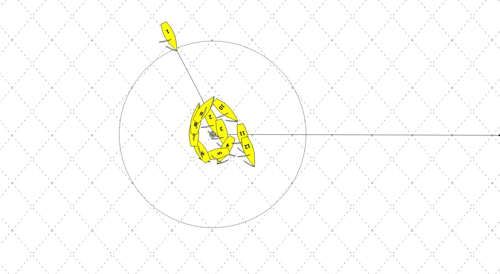

This scenario demonstrates the difference between a 360 degree penalty and  One Turn Penalty, and presents some flip-flops in the analysis.
Assumption
@1 Y reaches the zone clear ahead of other boats.
Y is entitled to mark-room (rule 18.2(b))
Hits mark
@2 Y touches the mark, and her bow also crosses the finishing line
Y breaks rule 31.
Y finishes in accordance with the definition.
At this point, Y has been given all the mark-room she is entitled to, and she is no longer entitled to mark-room (rule 18.2(d)).
Starts taking penalty
@3 Y is no longer touching the mark, and has begun making her turn to take her penalty for touching the mark.
Y begins to be required to keep clear of other boats in accordance with rule 22.2.
Suppose there had been another boat, that became overlapped with Y between @1 and @3 and was close to Y @3, there might be an issue whether Y complied with her rule 44.2 obligation to get well clear of other boats before beginning her penalty. If a protest committee concluded in hearing a valid protest that she had not complied with that obligation, then she would not have taken her penalty for breaking rule 31 in accordance with rule 44.2 and subject to being validly protested for breaking rule 31, she would be penalised for that breach.
@4 Y’s stern clears the finishing line: she is taking a penalty under rule 44.2 and has crossed the finishing line, so she ‘un-finished’ in accordance with Definition : Finish (a), and is still racing.
@4 Y continues taking her penalty.
@4 Y gybes onto starboard tack
  • With respect to any boat approaching the finishing line on port tack, Y will be on opposite tacks with her proper course at the mark to tack, thus rule 18 will not apply.
  • With respect to a boat approaching the finishing line on starboard tack, Y would be entitled to mark-room from any boat becoming overlapped outside her (rule 18.2(a)), but would remain required to keep clear of such a boat in accordance with rule 22.2, and would not be exonerated for any breach of rule 22.2 by rule 21. Because Y is manoeuvring below and outside the finishing mark, it is highly unlikely that any other boat on the finishing line side of the finishing mark is going to get overlapped outside her.
@5 to @6 Y continues taking her penalty
@7 Y is head to wind, still taking her penalty
@8 Y is past head to wind.
Y has tacked and has completed her penalty, no longer required to keep clear under rule 22.2.
Y becomes required to keep clear of other boats not tacking under rule 13.
Y becomes entitled to mark-room from any boat overlapped outside her, that is now, almost any boat approaching the finishing mark from the course side, which will exonerate her if she breaks rule 13 (rule 21).
@9 to @10 Y continues bearing away to finish.
@11 Y finishes
@12 Y’s stern clears the finishing line and Y is no longer racing.
