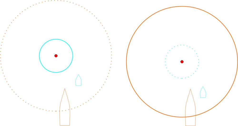

Yes, I was being a bit sloppy. The zone doesn't change when one overtakes the other, it changes when one is closer to the mark than the other, but it matters not, they are overlapped, and the rules don't distinguish between overlapped A slightly ahead and overlapped B slightly ahead anyway. So when does a boat reach the zone? Now, I submit that there is no definition of reaching the zone, the definitions states a boat is in the zone or not, and she's in the zone when any part of her hull is in it. ![]() So, in the L diagram the zone is the blue circle. No boat is in the zone, so no boat has reached it. In the R diagram a second later the orange zone applies, both boats are in the zone, so both boats have reached it. So that's the point at which clear ahead, clear astern applies. They reached the zone when the zone expanded. If you really want to dance on pins, if you consider boats gybing downwind that must gybe to make the mark, then it is possible to imagine blue being clear ahead and entitles to mark room when orange becomes closer to the mark and the boats have reached the newly expanded zone. But really, its not any different from any other situation where a boat clear ahead is further from the mark. The fact that the zone expanded doesn't seem to me to change anything. Actually the more complicated situation, it seems to me, is if the shorter boat becomes nearer to the mark, and the zone contracts such that neither boat is in the zone. But in practice that's still pin dancing, because if the boats are overlapped there isn't a problem, and if they are not overlapped there probably still isn't a problem, and in any case there's always 18.2.e Edited by JimC - 12 Jan 20 at 10:49am |
Not quite right. If boats were overlapped when the first of them reached the zone, the boat inside at that time is entitled to mark-room and continues to be entitled to mark-room even if later the overlap is broken or a new overlap begins (rule 18.2c(1)). That's the very nature of rule 18.2b 'enduring' mark-room. But the question we have to answer here is whether boats were overlapped when 'the first of them reached the zone'.
'Overtakes' is not a word used in the rules? <g> I don't agree that the Opti 'reached' the newly defined zone at the instant the NP got bow out on her: Arguably, the Opti had already reached that zone some time before. My inclination is to say that neither boat was clear ahead when she reached the zone, and boats were not overlapped when the first of them 'reached' the zone: rule 18.2b does not apply, but boats are overlapped in the zone therefore rule 18.2a does apply and whoever is inside is entitled to mark-room. That is to say, firstly, whoever is overlapped inside initially, is entitled to mark-room but if the overlap is broken, mark-room goes off, and is a new overlap subsequently begins, whoever is overlapped inside on the new overlap then gets mark-room. I would have thought that once the NP got her bow in front of the Opti it would be
Otherwise I don't think this interpretation is problematical. From the Opti's POV, while she is bow out, she knows that she has not reached her zone and isn't entitled to mark-room, so at the instant the NP gets bow out, the Opti shouldn't have been expecting to have mark-room. If the Opti had an ounce of sense, she'll be defending her wind like crazy, because if the NP gets over the top of her, she's going to die the death, so arguably if she lets the NP inside her, she's got nobody but herself to blame.
