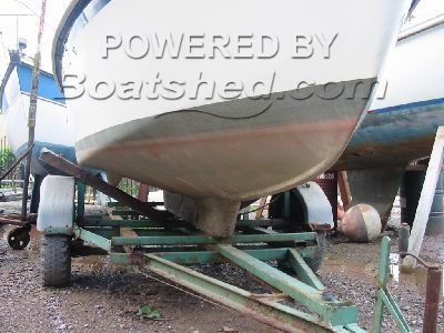

PeterG
Joined: 12 Jan 08 Location: United Kingdom Online Status: Offline Posts: 823 |
Posted: 16 Oct 18 at 11:05am |
Right, so it has a small keel as well as a C/B, so yes it should be able to sail reasonably upwind - though it will certainly perform significantly better if you can get the centreboard to work.
Do you know what the centreboard is made of? If it's heavy, cast iron, or similar, having it down will also improve the heeling stability, in addition to reducing upwind leeway.
Peter
JimC
Posted: 16 Oct 18 at 11:02am |
Well, with a stub keel like that it ought to be capable enough crosswind and even make some ground upwind on what would really be a close reach. If I had to get home upwind against the tide in a narrow channel I think I'd need an outboard motor, or else anchor up and wait until the tide changed.
pij27
Joined: 27 Jul 10 Location: Ryde / Tilbury Online Status: Offline Posts: 44 |
Posted: 16 Oct 18 at 10:39am |
Here is a pic of a similar boat, same model. |
Sam.Spoons
Posted: 15 Oct 18 at 4:29pm |
Is the boat in the water? If not the pics of the hull should give is a few clues?
