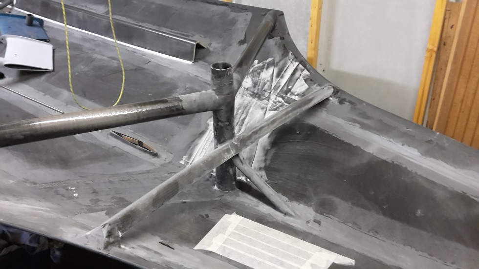

There are no holes currently, just the support.
![]() I think that it needs to have bolts in the holes when the track is bent to avoid it kinking at the bolt holes. I could use the pulling in technique but would need to transfer the bent hole positions across to the boat before bendint the track. alternativly I would fit bolts in all the holes and bend it by hand or with clamps |
Radius doesn't look very tight. I doubt you'l get kinking at the holes. Certainly looks a wider radius than the 29er track, and I never had a problem screwing that down from straight.
I'd just work from one side to the other, drilling and screwing down as you go.
Would it be worth cutting some narrow strips of ply the length of the track and using them as a tool to pull it down? Presumably you're going to have a hole each side of the centreline which would be straightforward to locate. If you pulled down on those and then clamp it in place and get the bend sorted out you could then mark the rest of the holes from the track in position.
