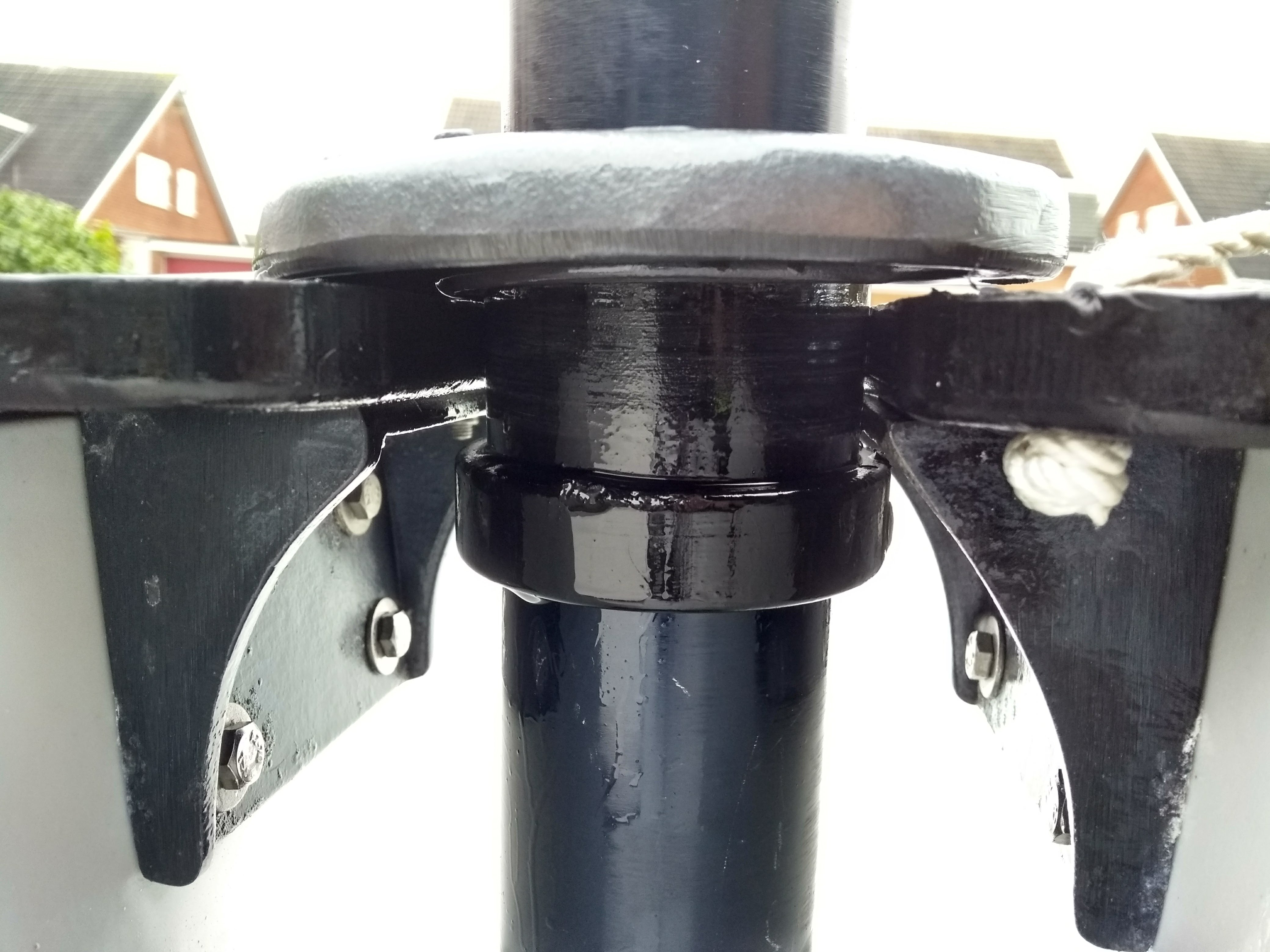

Hi all
New to the forum and new to sailing. I recently completed my RYA Levels 1 and 2, with most training done on a Laser Pico. Really enjoyed it so I've just bought a Pico of my own now. Great condition and all the parts seem to be there but I'm having trouble with one thing. From the training I attended, and from the Pico owners manual, I understand you should be able to furl the mainsail by rotating the mast (while it is still stepped). The problem I have is that when the mast is in place, the collar and mast gate fit together so tightly that I am unable to rotate the mast at all. I've checked that nothing else if fouling it, by just fitting the lower mast section and no other rigging - unfortunately the same problem. I applied some spray type silicone lubricant, after which I was able to shift the mast about a quarter turn - but still very stiff and only by using the downhaul cleat as a handle! (I wouldn't want to put any more sideways stress on this). I would by no means be able to do this afloat either. I thought it should rotate more freely than this? Am I doing something wrong? Or is this a problem anyone else has encountered? Any advice greatly appreciated! Many thanks in advance. Brett

Sounds like you might need to ease the joint a fraction. Try fine sanding the inside of the mast gate - you'll only need to take a fraction of a mm off.
Another possibility is that the gate part shuts too tight. Try putting a thin but of stiff wire down the locking pin hole, so it doesn't close fully, and see if the bottom mast rotates then. Don't try sailing it like this! If it rotates happily then, you might have to find someone to take another look at what is going on. Also, check the mast in another Pico. |
