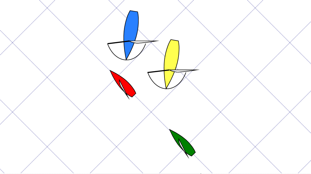

2 Boats running under spinnaker overlapped on starboard tack are approaching a line of boats in a different race who are on the starboard tack layline to their windward mark. Clearly as they are leeward boats the smaller boats all meet the definition of obstruction to the 2 overlapped boats.
There is a gap in the line of smaller boats that one of the overlapped boats may fit through, but not sensibly both. The windward overlapped boat is asking the leeward overlapped boat for room to pass behind the leading "layline" boat whilst the leeward boat is asking the windward boat to give room for them to pass ahead of the following "layline" boat. Question 1. As the leading "layline" boat is also an obstruction to the following "layline" boat (Clear astern) does she have an obligation to give the two spinnaker boats room to pass the leading layine boat? Question 2. If not, who gets to go through the gap?

![]() Something like that?
So: Yellow and Blue were overlapped, both on starboard, running towards red and green, both close hauled on starboard tack. There is insufficient space for both Y & B to sail between R & G. It's Y's choice, as leeward, RoW boat which side to leave the obstructions. If she leaves red to starboard and green to port (i.e. through the gap), then she is outside wrt R, but inside wrt G. Similarly, if both try and go through the gap then B is inside wrt R, but outside wrt G. I would have to wrap a damp towel round my head to think about whether "they have been unable to do so (give room) from the time the overlap began". Gut feel is that it applies - the gap is too small for 2 boats overlapped, and a gap that size always has been. Not sure how much it helps, though, because of the both inside/both outside probleim. Which means that if they force a passage through the gap, they're both guilty (as both outside and inside) of not giving room. Which implies DSQ both. Simple "head out of the boat, don't get involved with protests" solution is for both to duck red and green, go behind green where (hopefully) there's a bigger gap. If blue goes through the gap & doesn't give room to yellow, she's in danger of DSQ from the breach of 19 + (possibly) not keeping clear as a windward boat. Likewise, if yellow doesn't give room and forces blue to luff & flog her kite to avoid green, she's in danger of DSQ for a breach of 19. All a bit of a mare. Edited by Presuming Ed - 05 Oct 15 at 8:14pm |
I think if there's room for only one boat in a gap then the ROW boat gets it. That seems to me the way the rules are written. Part 2 rules limit the actions of ROW boats, they don't take away ROW. If the gap isn't big enough 19.2b doesn't apply to either boat.
What makes my head hurt a bit is the fact that yellow and blue are overlapped with green. I suspect that green must give them room to go behind reds stern. However I think there's a sting in the tail: green is still ROW boat, and there is no rule that says green must allow yellow and blue to sail their desired or proper course. Quite the opposite: the overlap was acquired from leeward so green is entitled to sail up to her proper course. So I rather suspect that if green bears away a bit to give yellow and blue enough room to round up behind red and go onto a beat then green has given them all the room she needs to, and if yellow and blue don't want to drop their kites and sail up the beat then that's tough. So in practice, I think blue is in deep trouble and needs to find a way out in plenty of time. Probably dump the kite and try to gybe behind yellow, because the alternative is going to be to drop the kite and spin up onto a beat. |

Thank you Presuming Ed for the Diagram, that was exactly right.
I'm glad I'm not the only one finding this one a bit of a brain pain. As you may have guessed I was one of the spinnaker boats, yellow to be precise. The situation developed faster than I, or I think the helm of the other boat, (which are both circa 40 foot yachts) appreciated. I was concentrating on passing ahead of green, and only really became aware that there was a problem with the size of the gap when blue came closer than I was comfortable with hailing that they would need room to pass astern of red. At this point I don't think it would have been possible for us to get behind green (where there was room in this case) in anything approaching a seamanlike way. So we did both go through the gap, uncomfortably close together, which didn't endear us to green.... However the protest time limit has passed, seemingly without green wanting to spend time and effort in a complicated protest with two boats from a different class. Can't say I overly blame him for that. I am left wondering what would have happened in a protest though. So this was really one of those that I was trying to dissect afterwards, as opposed to being fully aware in the build up and making an active call. But hopefully with an idea as to what to do if the situation occurs again, which is possible given the nature of solent racing. So far though everyone seems as stumped as I am! There does seem, in general, to be a small problem with the rules when different "room" situations conflict. See my previous effort here. http://www.yachtsandyachting.com/forum/forum_posts.asp?TID=11141&title=which-takes-precedence-18-or-19 |
