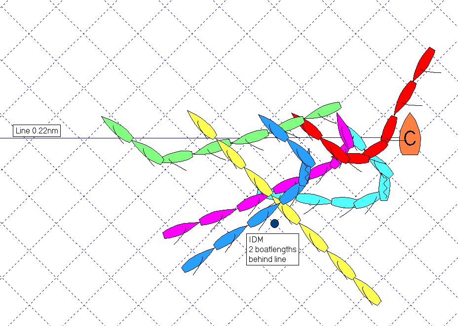

Q&A 2010-033 (Lapsed)
C 003 Q&A 2010-33
Published: 6 October 2010
Situation
The sailing instructions at an event state:
‘An inner limit mark may be laid, but not necessarily on the starting line. If laid, yachts shall pass
the inner limit mark to starboard when starting’.
Note: The diagram shows different boats, but they are all independent examples. No boats are
OCS at the starting signal, and no special starting rule applies.
Question
Which, if any, of the various boats in the attached diagram (green, blue, red, yellow, magenta,
cyan), break rule 28.2.
Answer
None. Although boats are racing from the preparatory signal, a starting mark (including a starting
line limit mark which are sometimes laid to restrict the length of the actual starting line) has no
required side before a boat is approaching the starting line from its pre-start side to start (rule
28.2). At that time, the starting marks get a required side, although they don’t yet 'begin, bound or
end’ the leg a boat is on’.
The string test does not start until the boat starts and rule 28.1 says that 'after starting and until
finishing ..... 'the string must pass each mark on the required side.
For a starting line inner (or outer) limit mark to have a required side, a boat must not be able to
pass between it and the starting line if it is on the pre-start side of the starting line or be
somewhere within a reasonable distance on the course side of the starting line.
The sailing instruction for this event uses the words ‘yachts shall pass the inner limit mark to
Therefore, if a boat can pass and clear the starting line limit mark before she actually starts, as in
each of the situations described here, she can not be penalised for breaking that instruction and
would be exonerated due to the error in the placement of the mark by the race committee.
Edited by Brass - 21 Jun 14 at 10:55am

Post Options Post Options   Quote andymck Quote  Post ReplyReply Direct Link To This Post Posted: 20 Jun 14 at 3:29pm
Brass gets there again. 2 boat length example, I have used to my advantage before. I have only ever seen this as an issue on a shore based start. On a committee boat a rope as described puts people off, but have seen the blue and cyan examples pulled off
