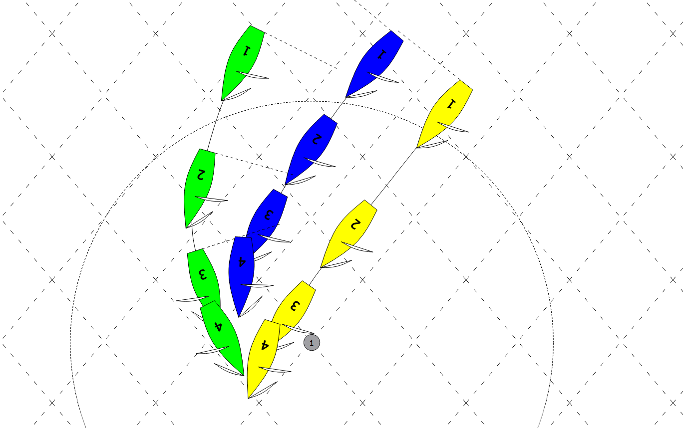

Something like in this diagram? ![]() There is no requirement in the rules for any hail of any sort in connection with entitlements to mark-room. Requirements for hails for room at marks were deleted in the 1995 rules rewrite. Your scenario says boats were all on starboard, and all overlapped when the first of them reached the zone (presumably this was A, but it could have been any one to get rule 18.2( b ) to operate. That being the case, A, as inside boat is entitled to mark-room under rule 18.2( b ) and will continue to be entitled even if later an overlap is broken or a new overlap begins, as you have rightly observed under rule 18.2( c ). Rule 18.2( b ) gives an entitlement to mark-room to a boat overlapped inside when either boat reaches the zone or a boat clear ahead when she reaches the zone. That would be A and B in this case. The only way C is not required to give mark-room under rule 18.2( b ) and to continue to give it under rule 18.2( c ) is IF she 1. If C reached the zone first and was clear ahead of A, then C is the boat entitled to mark-room under rule 18.2( b ), and retains it under rule 18.2( c ). 2. If A reached the zone first with C clear ahead and not yet at the zone rule 18.2( a ) applies and rule 18.2( b ) does not, but rule 18.2( a ) only entitles a boat to mark-room when she is overlapped inside (See Case 2). a. While boats are clear ahead/clear astern, there is no mark-room under rule 18.2( a ). b. If C initially clear ahead, bears away to gybe, she will inevitably become overlapped outside A and A will then be entitled to mark-room, while they are overlapped. c. Supposing C then sailed across A’s stern, she would then be clear astern of A and neither would be entitled to mark-room, then if C managed to become overlapped inside A, then A would be required to give C mark-room. In other words, if C is overlapped or coming from behind, she is going to owe mark-room and continue to owe it all the way round. And, as long as C was never claiming to be clear ahead before reaching the zone, whether or not the overlap was broken is irrelevant, so you don't need to go near rule 18.2( d ). By the way, you said 'the Protest Committee would focus on whether A had established a right to Mark Room from C - or not': the protest committee wouldn't really need to do that: C is required to keep clear of A throughout, and unless C gets mark-room, rules 11 and 10 will be quite enough to decide the matter. I get the feeling that in your case, where you say C believed that A had not established a right to mark-room, C was thinking that when B and A slowed while in the zone, she managed to pass to windward, and get clear ahead, and that, somehow getting clear ahead (after A and B had reached the zone) changed the entitlement to mark-room. She's wrong. It doesn't.

Brass, Jim, thanks for your comments. The situation was roughly as per your diagram but I would put A (yellow) alongside B (blue) at points 2, 3 and 4. Also at point 4, C (green)'s bow was almost at the mark and she was at right angles to the course of yellow.
